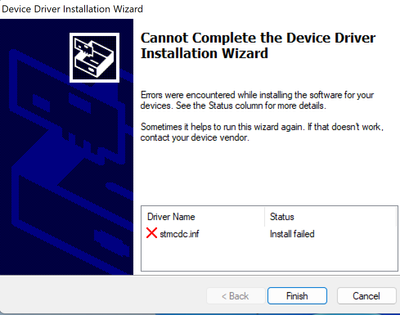

Hi I am new here. I am looking for a driver for Windows 11 Arm (parallels M1).
The chip on my board says STM32F105. The driver that worked for me last time on other Windows was:  dpinst_amd64
Can someone advise a driver for Windows 11 Arm (running Parallels Desktop on M1) Thanks

OK, so I contacted with a manufacturer again, and he said: basically I am using a StarterKit stm32f105. The problem is with connection of this starter kit by USB on Windows 11 ARM when I use examples of your code for working with USB in VCP mode, which came with your kit.
https://github.com/STMicroelectronics/STM32CubeF1/tree/master/Projects/STM3210C_EVAL/Applications/USB_Device
A CDC would come up as a serial port, likely usable with USBSER.SYS, in years before you could munge the .INF files to associate the VID/PID with the USB Device

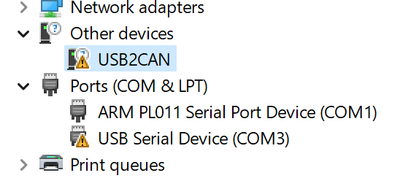

 OK, I give up. Unfortunately I am not an IT guru. I need only this to be installed: 
Thanks for the information above, but I am really can't understand it
Go fish STMCDC.INF out of your \WINDOWS\INF directory, and figure out how to add a [DeviceList.xyz] node for your ARM installation, perhaps browse other working .INF files?
Should be a Microsoft USBSER.SYS device for ARM. Check what the .INF for the "ARM PL011" looks like. Say use "grep" or some file manager of your choosing.

https://github.com/LORD-MicroStrain/Drivers/blob/master/Windows/Inertial/ST_VCOM/stmcdc.inf

Is it this "starter kit"?  https://www.farnell.com/datasheets/2308485.pdf
The "USB serial device (COM3)" can be usbser.sys, not sure what is the "USB2CAN".
