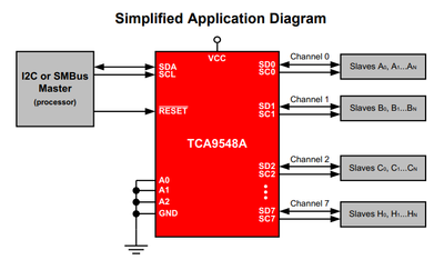

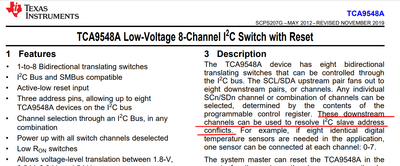

The multiplexer i mentionoed is TCA9548A.
So this:
https://www.ti.com/product/TCA9548A
Yes, as its datasheet shows, that is designed to allow a single I2C Master to connect to multiple I2C buses:

As ı understand, TCA9548A is used for connecting same sensors
Generally, yes - or, at least, devices which all have the same I2C Slave Address.
@yasinbjk50 wrote:
 Is it appropriate device for my project?
Probably not: all your sensors should have different I2C Slave Addresses - so you shouldn't need a multiplexer for that.
Unless you have some other specific reason for it?

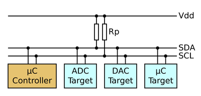

The whole point of a bus is that it can be shared by multiple devices - I2C is a bus.
You can connect multiple devices to an I2C bus - it is the Slave Address which distinguishes them.
Example from Wikipedia:
Perhaps you need to read-up on the I2C bus:
https://en.wikipedia.org/wiki/I%C2%B2C
