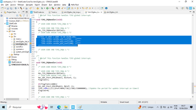

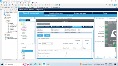

I'm trying to update the duty cycle of 3 channels of timer 1 simultaneously with just one DMA event.

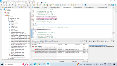

Hello @RaulPosada
In the TIM2_IRQHandler, your code attempts to directly assign values to the DMA channel's Control Register (CCR):
DMA1_Channel4->CCR = a * fasea[theta];
DMA1_Channel5->CCR = a * faseb[theta];
DMA1_Channel6->CCR = a * fasec[theta];
 This is not the correct way to update the duty cycle of the PWM channels. The CCR of the timer channels should be updated with the duty cycle values, not the DMA channel's CCR. The DMA channel's CCR is used to configure the DMA channel itself, not to transfer data.
Also, the variable "theta" that you're declaring, needs to be a valid index within the bounds of the arrays
I suppose it represents an angle,in this case it needs to stay within the range of 0 to 359, which corresponds to the valid indices for the arrays.
So, theta needs to be properly defined, initialized, and updated somewhere in your code
Also, this line is not clear to me:
a=(((1/((Wref/4096)*10))/360)/150000000);

Hello @RaulPosada, welcome to ST community,
Yes, you can use the DMA burst mode to update multiple Capture/Compare Registers (CCRs) of a single timer simultaneously with one DMA request, which is triggered by the timer's update event.
If you need more details on burst mode, you can refer to the Timer cookbook AN4776
Otherwise, can you be more specific about your question? what's working and what's not... maybe include a code snippet using </>

In the image above, there's a section marked in blue, which is what I'd like to implement using DMA. Below, I attempted a different approach but without success.
Here is my stm32g4xx_it.c
#include "main.h"
#include "stm32g4xx_it.h"
/* USER CODE END Includes */
/* USER CODE BEGIN TD */
/* USER CODE END TD */
/* USER CODE BEGIN PD */
/* USER CODE END PD */
/* USER CODE BEGIN PM */
/* USER CODE END PM */
/* USER CODE BEGIN PV */
uint32_t Wref=0;
uint32_t Ishunt=0;
int flagTim3=0;
int theta;
int a=0;
/* USER CODE END PV */
/* USER CODE BEGIN PFP */
/* USER CODE END PFP */
/* USER CODE BEGIN 0 */
/* USER CODE END 0 */
/* External variables --------------------------------------------------------*/
extern DMA_HandleTypeDef hdma_adc1;
extern DMA_HandleTypeDef hdma_cordic_read;
extern DMA_HandleTypeDef hdma_cordic_write;
extern DMA_HandleTypeDef hdma_tim1_ch1;
extern DMA_HandleTypeDef hdma_tim1_ch2;
extern DMA_HandleTypeDef hdma_tim1_ch3;
extern TIM_HandleTypeDef htim2;
extern TIM_HandleTypeDef htim3;
/* USER CODE BEGIN EV */
extern ADC_HandleTypeDef hadc1;
extern ADC_HandleTypeDef hadc2;
extern float fasea;
extern float faseb;
extern float fasec;
/* USER CODE END EV */
void TIM2_IRQHandler(void)
  /* USER CODE BEGIN TIM2_IRQn 0 */
  /* USER CODE END TIM2_IRQn 0 */
  HAL_TIM_IRQHandler(&htim2);
  /* USER CODE BEGIN TIM2_IRQn 1 */
  DMA1_Channel4->CCR=a*fasea[theta];
  DMA1_Channel5->CCR=a*faseb[theta];
  DMA1_Channel6->CCR=a*fasec[theta];
  /* USER CODE END TIM2_IRQn 1 */
  * @brief This function handles TIM3 global interrupt.
void TIM3_IRQHandler(void)
  /* USER CODE BEGIN TIM3_IRQn 0 */
  /* USER CODE END TIM3_IRQn 0 */
  HAL_TIM_IRQHandler(&htim3);
  /* USER CODE BEGIN TIM3_IRQn 1 */
  HAL_ADC_Start_DMA(&hadc1, &Ishunt, 1);
  flagTim3++;
  if(flagTim3==1000){
  HAL_ADC_Start_DMA(&hadc2, &Wref, 1);
  TIM2->ARR=a; //Update the period for update interrupt on timer2
  TIM2->CNT=0;
  flagTim3=0;
  /* USER CODE END TIM3_IRQn 1 */
