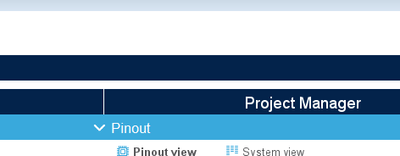

To see pin compatible cpus, just open in Cube the -> Pinout    tab:
select pin compatible cpus --- and you get a list (or not ) :)
Just guessing : something like STM32L476ZG might fit...with 1M flash here.

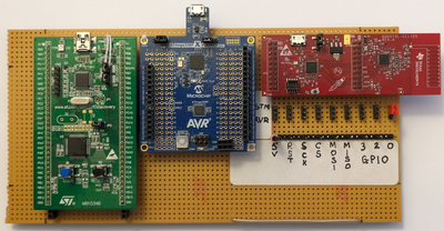

Here, I'm porting from an AVR to an STM32; so two completely different architectures - not even the same family or same manufacturer!
