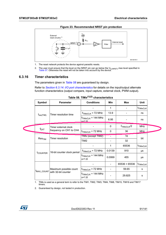

We're looking at using a STM32F303RE for a project. One of the requirements is being able to measure the frequency of a square wave ranging from 1MHz - 40Mhz. I've been looking at the General-purpose timer cookbook (AN4776) and trying to get the frequency counter sample application working on the F303 platform but have so far been unsuccessful but that's another issue.
However, as I become more familiar with the way that code works, I'm concerned that it won't work at these higher frequencies. if the system clock is 72MHz, trying to count the CC2R clock counts latched at 40Mhz will only give counts of 1 or 2, right? I guess we could build a divisor circuit to condition the input signal down from 40Mhz by a factor of 16 or 32?

At high frequencies you generally count the pulses, not measure the period, integrate over a fixed/known time and compute frequency. ie External Count mode
Interrupts reach saturation at relatively low frequencies (few hundred KHz)
Don't use interrupts.
Consider using PWM Input Mode, and reading the CCR1/CCR2 when interested.
The inputs have a 1, 2, 4, and 8 Input Prescaler, ie can measure 8 periods

waclawek.jan
April 24, 2019
> So I don't really care about the time base of the timer, I just want it to increment a counter (up to 40Mhz)
The input frequency can't be more than half of the internal timer clock, i.e. 36MHz if you clock it at 72MHz; see my post below.

Vangelis Fortounas
April 24, 2019
Hi.
To measure the frequency of a square wave 1-40 MHZ
1. Need an input. This is the clock source for counter 2 and can be only the ETR for timer 2.( note that max input freq is 36 MHZ )
2 Need a Time Base . This can be internal clock or an external more stable clock source like an OCXO,TCXO. If your intention is to use the internal clock to measure freq, then F_72Mhz, must be converted to a more suitable frequency to do this job. In practice, the period need to measure the frequency is from milliseconds to several seconds.
This Time Base will trigger one of the CCRegisters to capture the current value of Counter(there is no need to read the counter directly)
So, this time base, periodically, and automatically , catch the value of counter and can call an ISR. inside the ISR, subtract the previous catched value from current catched value and by dividing this result with time base period, you have the Frequency you want.
3. To produce the time base (without connect any external wire between pins, but internally ) is little bit tricky. Tim 2 will configure as Slave Trigger Mode and triggered from eg Timer3 (ITR2) or Timer4 (ITR3) as master. (we call it TimerM). TimerM must be configured as Master and Update_Event output to Timer2.
TimerM will have clock input the internal clock, prescaled appropriately to give an Update_Event at a desirable measurement period (eg 1 sec or 10msec).
Automatically, Freq calculation will be done inside ISR every period you prefer (usually bigger than milliseconds)
Don't use the Timer 2 as Slave_Reset_Mode. It is more easy, no need ISR, but introduce inaccuracies at every cycle because the extra delay need to reset and start again the timer.
