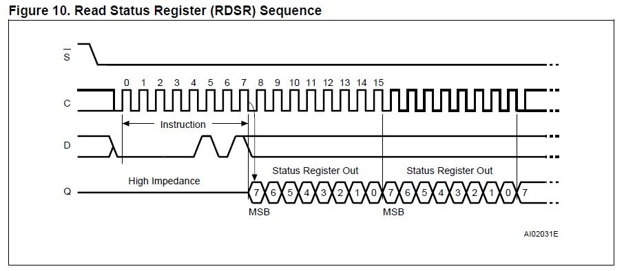

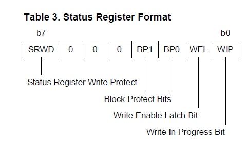

When I read RDSR data  is  0x0104
I don't know mean
0690X000006C0EjQAK.jpgWhen I see data sheet  RDSR is only 8 bit
But read 2 byte.

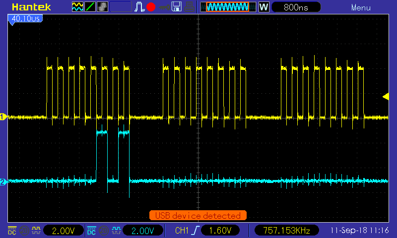

MISO Pin  GPIO_Mode_AF_PP or GPIO_Mode_IN_FLOATING
both  Work is Good.
RDSR Read Data 0x02 0x02

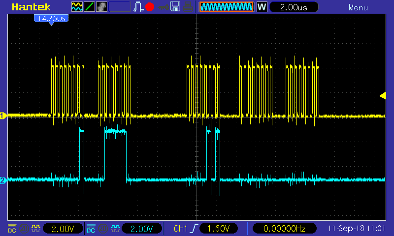

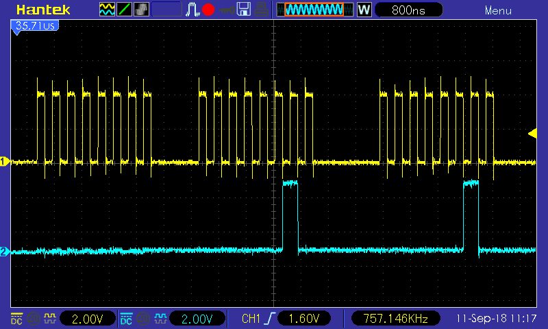

Kim Sang Hyouk
​now Just can Read RDSR
  while(1){
    M95512_WRDI(); //Write Disable
    Error = M95512_RDSR();
    delay_us(1);
    M95512_WREN(); //Write Enable
    delay_us(10);
When I test .... Cand Read 0x00  0x00    and  0x02  0x02
But Can't Read
void Read_Door_Sens(void){
  unsigned char data;
  ADDRESS = 0x0000;
  EEPROM_CS_LOW();
  SPI_SendByte(READ);   //0x03
  SPI_SendByte((ADDRESS & 0xFF00) >> 8);
  SPI_SendByte(ADDRESS & 0xFF);
  data = SPI_SendByte(DUMMY);
  EEPROM_CS_HIGH();
  Door_Sens_Use = data;
void Write_Door_Sens(unsigned char data){
  ADDRESS = 0x0000;
//  M95512_WREN();
  EEPROM_CS_LOW();
  SPI_SendByte(WRITE);//0x02
  SPI_SendByte(data);
  EEPROM_CS_HIGH();
MOSI Signal Can work.
But MISO Signal Can't work.
