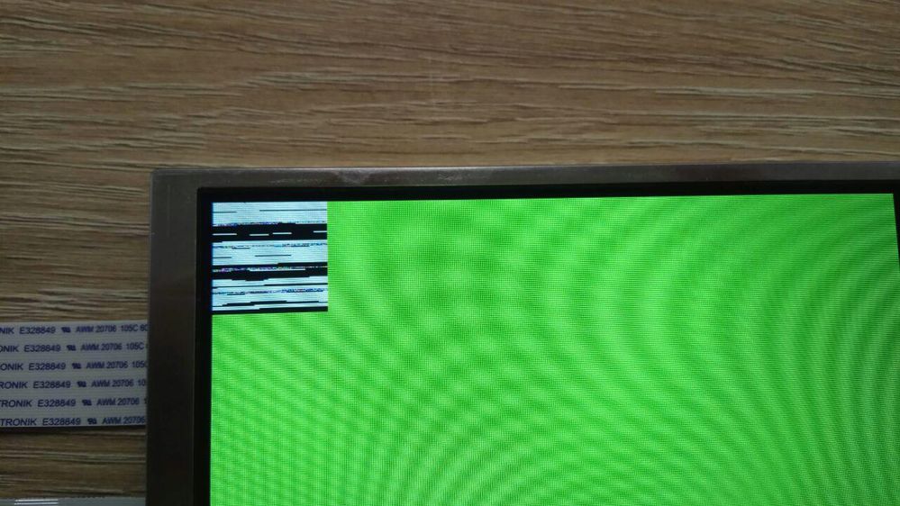

Hello.
When I loaded the array into Flash (used const) It was displayed on the screen
But as soon as I use RAM to store the image it stops displaying, I see a black square
I also can not fill the color programmatically LTDC just does not react

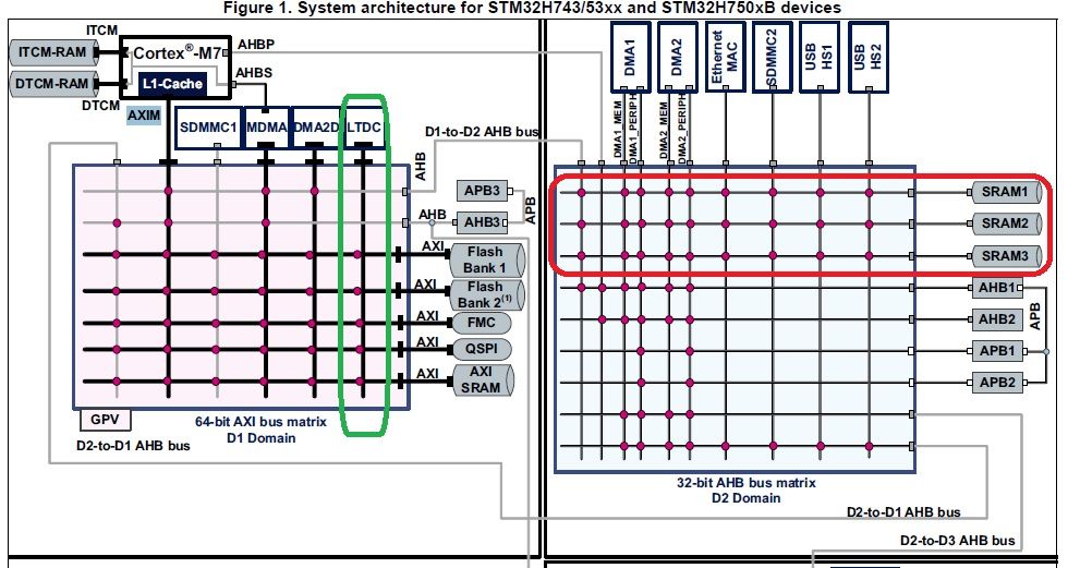

What RAM?
The LTDC needs the data in the AXIM RAM

>>So I have to run an external SDRAM?
No
>>I was just creating an array (uint8_t image[100 * 100])
Pay attention to the memory region from which it gets allocated, review linker script or scatter file, and that it describes available memories properly, and that you direct allocations from the appropriate pools/sections.

In linker script script there is
MEMORY
	DTCMRAM (xrw) : ORIGIN = 0x20000000, LENGTH = 128K
	RAM_D1 (xrw) : ORIGIN = 0x24000000, LENGTH = 512K
	RAM_D2 (xrw) : ORIGIN = 0x30000000, LENGTH = 288K
	RAM_D3 (xrw) : ORIGIN = 0x38000000, LENGTH = 64K
	ITCMRAM (xrw) : ORIGIN = 0x00000000, LENGTH = 64K
	FLASH (rx) : ORIGIN = 0x8000000, LENGTH = 2048K
Do I need RAM_D1 or RAM_D2 or RAM_D3?
