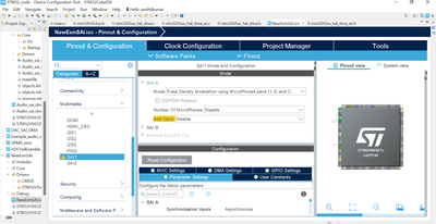

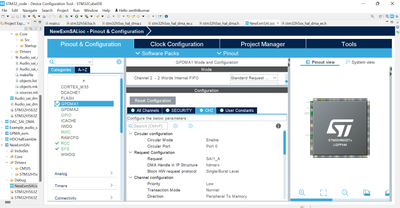

I am using PDM mems microphone to configure the STM32H563ZI SAI_A with GPDMA. I have attached the image of configuration details. After configuration I generate the code, But GPDMA initialization details not showing in the code.

Hello @Srmssenthil and welcome to the Community :),
GPDMA initialization code can be found in the generate stm32h5xx_hal_msp.c file.
I tested this behavior with STM32CubeMX6.12.0 version and the GPDMA is well initialized in the generate stm32h5xx_hal_msp.c file.
/* Peripheral DMA init*/
NodeConfig.NodeType = DMA_GPDMA_LINEAR_NODE;
NodeConfig.Init.Request = GPDMA1_REQUEST_SAI1_A;
NodeConfig.Init.BlkHWRequest = DMA_BREQ_SINGLE_BURST;
NodeConfig.Init.Direction = DMA_PERIPH_TO_MEMORY;
NodeConfig.Init.SrcInc = DMA_SINC_FIXED;
NodeConfig.Init.DestInc = DMA_DINC_FIXED;
NodeConfig.Init.SrcDataWidth = DMA_SRC_DATAWIDTH_BYTE;
NodeConfig.Init.DestDataWidth = DMA_DEST_DATAWIDTH_BYTE;
NodeConfig.Init.SrcBurstLength = 1;
NodeConfig.Init.DestBurstLength = 1;
NodeConfig.Init.TransferAllocatedPort = DMA_SRC_ALLOCATED_PORT0|DMA_DEST_ALLOCATED_PORT0;
NodeConfig.Init.TransferEventMode = DMA_TCEM_BLOCK_TRANSFER;
NodeConfig.Init.Mode = DMA_NORMAL;
NodeConfig.TriggerConfig.TriggerPolarity = DMA_TRIG_POLARITY_MASKED;
NodeConfig.DataHandlingConfig.DataExchange = DMA_EXCHANGE_NONE;
NodeConfig.DataHandlingConfig.DataAlignment = DMA_DATA_RIGHTALIGN_ZEROPADDED;
if (HAL_DMAEx_List_BuildNode(&NodeConfig, &Node_GPDMA1_Channel2) != HAL_OK)
Error_Handler();
if (HAL_DMAEx_List_InsertNode(&List_GPDMA1_Channel2, NULL, &Node_GPDMA1_Channel2) != HAL_OK)
Error_Handler();
if (HAL_DMAEx_List_SetCircularMode(&List_GPDMA1_Channel2) != HAL_OK)
Error_Handler();
handle_GPDMA1_Channel2.Instance = GPDMA1_Channel2;
handle_GPDMA1_Channel2.InitLinkedList.Priority = DMA_LOW_PRIORITY_LOW_WEIGHT;
handle_GPDMA1_Channel2.InitLinkedList.LinkStepMode = DMA_LSM_FULL_EXECUTION;
handle_GPDMA1_Channel2.InitLinkedList.LinkAllocatedPort = DMA_LINK_ALLOCATED_PORT0;
handle_GPDMA1_Channel2.InitLinkedList.TransferEventMode = DMA_TCEM_BLOCK_TRANSFER;
handle_GPDMA1_Channel2.InitLinkedList.LinkedListMode = DMA_LINKEDLIST_CIRCULAR;
if (HAL_DMAEx_List_Init(&handle_GPDMA1_Channel2) != HAL_OK)
Error_Handler();
if (HAL_DMAEx_List_LinkQ(&handle_GPDMA1_Channel2, &List_GPDMA1_Channel2) != HAL_OK)
Error_Handler();
__HAL_LINKDMA(hsai, hdmarx, handle_GPDMA1_Channel2);
if (HAL_DMA_ConfigChannelAttributes(&handle_GPDMA1_Channel2, DMA_CHANNEL_NPRIV) != HAL_OK)
Error_Handler();
