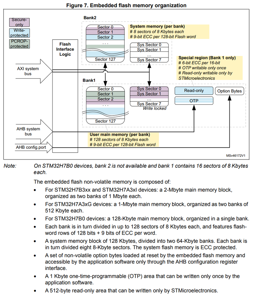

The Flash memory is organized as follows:
• Two independent 1 Mbyte banks of user Flash memory, each one containing 128 user sectors of 8 Kbytes
each.
• 128 Kbytes of System Flash memory from which the device can boot.
• 1 Kbyte of OTP (one-time programmable) memory containing option bytes for user configuration
Shouldn't this read:
• Two independent 1 Mbyte banks of user Flash memory, each one containing 8 user sectors of 128 Kbytes
each.
2022-08-17 6:57 PM
I spose I should RTFM!!!

    { 0x081E0000, 0x20000, 7, 2},        /* flash sector idx 15 - 128kb                */Never ASSUME... it makes an *** out of U and ME
So the fact is:
H74x devices have 8 sectors of 128K
H7A(B) device do indeed have 128 sectors of 8K
Go figure
Equipped with this knowledge openblt struct should be:
static const tFlashSector flashLayout[] =
/* (BOOT_NVM_SIZE_KB == 2048) */
      {0x8020000,0x2000,16,1}, /* flash sector idx 16 - 8kb        */
      {0x8022000,0x2000,17,1}, /* flash sector idx 17 - 8kb        */
{0x81FA000,0x2000,125,2}, /* flash sector idx 125 bank2 - 8kb        */
      {0x81FC000,0x2000,126,2}, /* flash sector idx 126 bank2 - 8kb        */
      {0x81FE000,0x2000,127,2}, /* flash sector idx 127 bank2 - 8kb        */

2022-09-04 6:33 AM
>>Understandably the STM327A(B) chips are very different beasts to the STM327xx series
The H7's are a random bag of spanners..
The smaller uniform flash blocks honestly more helpful than the large ones making the H7B0 a lot more usable than the H750's if you assume there's only 128KB available. I hadn't picked up on all the differences, especially the 8KB blocks.
The H72x and H7Ax have OCTOSPI
