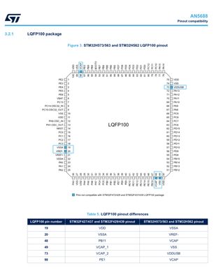

I was very disappointed to note that STM32H743VIT6 is not pin compatible with STM32F407VGT6 in the LQFP100 enclosure.
It would be nice if MCU F7 and H7 could replace F4, without having to redo the PCB board again.
Dear @RhSilicon ,
Unfortunately it is not possible from F4 to H7, here is the last series we released STM32H5 with Cortex-M33 secure core instead of M4 core and this is below the best we have done to keep pin compatibility ( strongly  requested by our customers like you ) . For LQFP 100 package
 thank You very much for the valuable feedback! Minor re-spin of PCB is required on these few power pins .

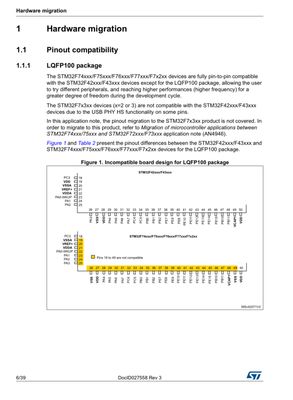

Dear @RhSilicon ,
Indeed LQFP100 is the only package not pin-to-pin compatible with STM32F7 series due to optimized performances and sustain the power rails . Here is attached screenshots from our Application note of Migration

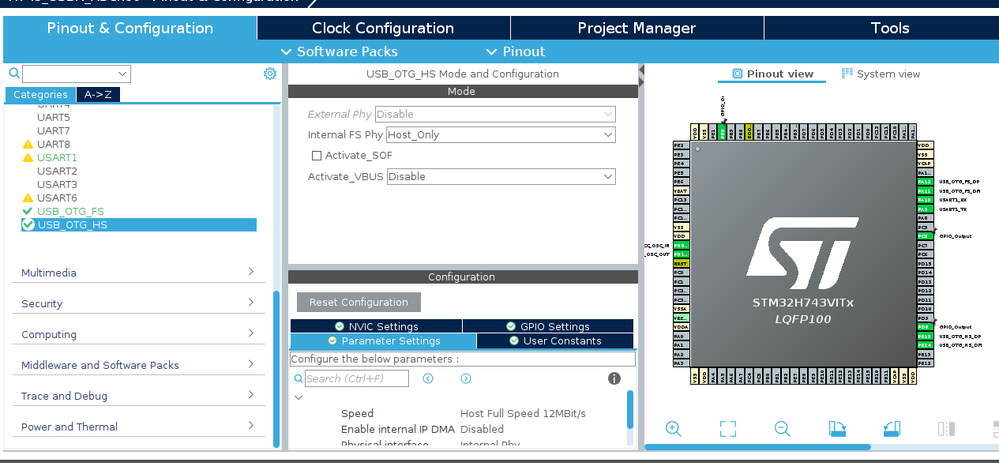

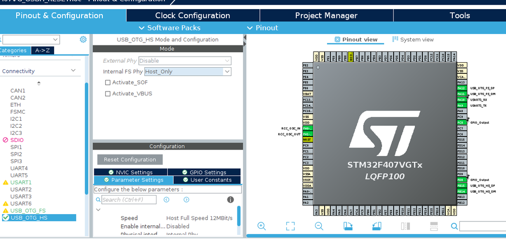

I just need the USB Host to stop crashing in the enumeration.
Do all line 4 MCUs (F4, L4, G4) have the same USB OTG design?
I found this, about peripheral mode:
"When we ported the USB (device) driver to the L4 we had problems because a strange behavior of the OTG peripheral, we had to introduce workarounds in the driver, I don't know if the host mode driver could be affected in a similar way."
[No interrupt generated on USB device connection while USB OTG_FS core is running as USB host only]
http://forum.chibios.org/viewtopic.php?t=4966
Dear @RhSilicon,
Yes, on all of these products MCUs the USB Peripheral can be configured either a Host or a peripheral in Full speed mode ( using internal PHY) or High Speed HS using ULPI external PHY, except the F72x that embeds a High Speed PHY in addition to the full speed PHY.
now, regarding a potential issue in enumeration or detecting VBus presence I would suggest to debug the issue or to start from reference examples we provide in CubeMX or GitHub and then to add the features in the software stack to be robust enough in your application. If it persist , you escalate the case and have a Direct FAE helping you locally .

Thanks for the information, just to confirm, do all products that have internal Full-Speed (FS) USB OTG PHY have the same silicon lithography design on the PHY module? Including the H7 line?
I ask this because I was thinking of making a new PCB board using MCU H743, but if the internal FS USB OTG PHY of H743 is the same as that of F407, then I will try to work around some problem locally
F407:
I recently learned that the H743 has a Y and V revision. Is there any possibility that there is a revision in the silicon lithography of the internal USB OTG PHY Full-Speed (FS) PHY, which allows for greater robustness?

Dear @RhSilicon ,
