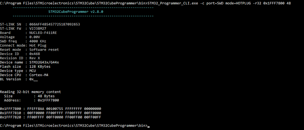

    One more thing off the list. I did use the STM32CubeProgrammer with ST-LINK and read all the Flash Option bytes. The address read is 0x1FFF7800 length 48 bytes. I think this is the correct procedure ...

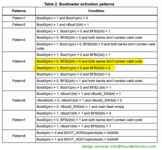

    I've just read AN2606 and "Table 2. Bootloader activation patterns" possibly may explain your problem:
    0693W00000HpaiOQAR.pngUse ST-Link utility and make screenshots of option bytes configuration and each bank beginning address content, compare them. Try to erase chip and reset all option bytes to their default state and repeat 0x7F experiment for both boards. I haven't used BFB2 bit, but as seen from this table you can't get to embedded bootloader in some cases (flash not empty, different option byte values). Probable cause may be that chips was already programmed before (de-soldered chips, pre-programmed chips).

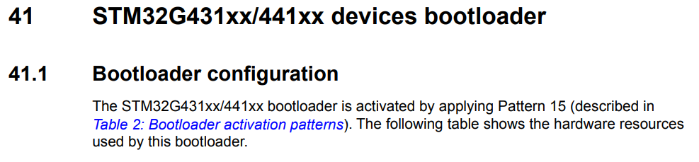

    I will check out the option bytes, but the part I'm using is a STM32G431 which uses pattern 15:
