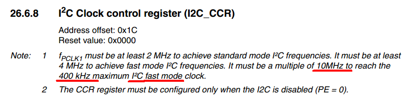

I want to use I2C fast mode(400KHz) and USB full speed mode in parallel. My controller is STM32F103VCT6. In reference manual I had read that for USB we must use 48MHz clock and also for I2C fast mode communication  i2c clock frequency must be a multiple of 10MHz . I'm not able to set a sysclk compactable for these two peripherals. Is there any solution for this? Please help...

In reference manual RM0008 they had written, for i2c fast mode operation i2c clock frequency must be a multiple of 10MHz. To achieve this I had set SYSCLK 40MHz (HSE: 8MHz and PLL :5). Configured Duty bit as 1(in I2C_CCR register,Actually I didn't understand yet the purpose of duty bit. I have attached the images from RM0008) . I had tested with this configuration and I was able to get fast mode I2C frequency(400KHz ).
But while integrating with USB full speed configuration I got stuck because USB
requires
48MHz clk  frequency to work. Due to this I can only give sysclock 72MHz or 48MHz
to make USB working. By changing sysclk to 72MHz I2C clock becomes 36MHz(not a multiple of 10MHz). Using this clock configuration I tested I2C fast mode again. But now my I2C clock frequency changed from 400KHz to 480KHz(Data transfer is working normal) . But my requirement is 400KHz . I want use USB also.....
I believe that u are able to understand my problem now... Is there any solution for this....?
I tested with 48MHz sysclk and I couldn't acquire 400KHz
My requirement is I2C fast mode(400KHz) + USB full speed

Having 10MHz multiple at Pclk is only required to reach 400KHz exactly. Because the IIC in 16/9 duty mode requires 400Hz*(16+9)=10MHz input clock. Apparently the clock tree cannot generate that.
With another pclk speed, you can either run slower than 400KHz or change duty to 2/1. It will maybe run out of II2 fast mode spec but can be possibly supported by your slave device.
With 36MHz Pclk, duty 16/9, CCR=4, the speed should be 360KHz.
With 36MHz Pclk, duty 2/1, CCR=30, the speed should be 400KHz.

Thankyou... this is helpful ...I want to test using this configuration by updating I2C_CCR register.  So as per my understanding to reach exact 400KHz multiples of 10MHz need to use for I2C clk. By 36MHz I2C clk(pclk1) by adjusting CCR value we are able to reach around 400KHz not exact. Is this correct?

For 400KHz exact we should use I2C clk as a multiple of 10MHz. And to achieve around 400KHz( May a greater value or lesser value but near to 400KHz) by changing CCR values in I2C_CCR register (What
