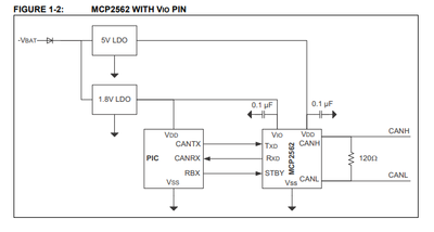

what is the "module" here ?
If you mean a driver chip : yes, you need one on every cpu-> CAN bus; transforms rx/tx from cpu to CANH/CANL symmetrical/complement signal line..
Something like this :
MCP2562 doing 3,3v cpu -> 5V standard CAN bus voltage level; and termination 120r on every end of line.
is about $ 1,50 on every cpu , and you work with real conditions, can connect to other CAN bus devices also.

2024-03-02 5:39 AM
The term 'module' referred to the transceiver, but as far as I understand, I need to purchase it to work on STM32. Thank you.
2024-03-02 6:15 AM
You need something to merge the signals. There's a low cost method with diodes and a resistor you can use to experiment at a board level.
https://www.keil.com/appnotes/files/apnt_236.pdf
2024-03-02 6:33 AM
I was planning to buy MCP2551, but since it's not sold in my country, I will buy the SN65HVD230 module. Is it compatible with STM32F407?
2024-03-02 7:33 AM
I expect so, it's been used on several of the STM32 EVAL boards
