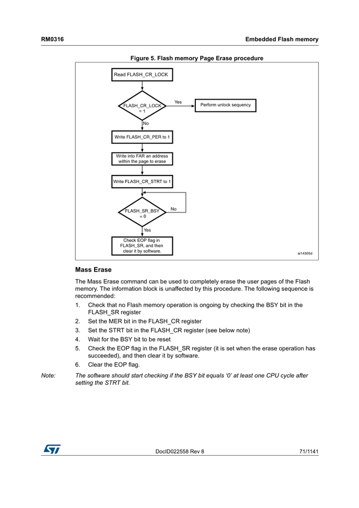

Hello, I have a question:
  • Is it possible to erase full chip (for example... erase full chip after counter value get value 100)?
I'm using stm32f303cb.
Thank you for your time,
Domen

waclawek.jan
What counter? Do you mean, can the chip erase itself? Have you read the FLASH chapter in manual?
0693W00000QNxUjQAL.pngJW
Peter BENSCH
I understand the question to mean that you want to delete the flash when a counter reaches a certain value, right?
This is possible by moving the erase routine to RAM and starting it there, but the power supply could fail during the erase process, which might not completely erase the flash.

DIvan.1
Yes, you are right.
Okey, thank you for your advice. Can you direct me how to do this?

waclawek.jan
Read the FLASH chapter in RM I referenced to above, it contains all the information you need.
