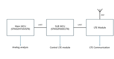

I'm using STM32H733VGT6, STM32F030CCT6 and LTE module.
As show as attached picture, it is conneted via UART.
I want to recieve data through LTE and connect STM32H733VGT or STM32F030CCT to DFU to download firmware.
Is it possible with UART?
STM32H733VGT have USB DFU, but I want to use UART.
Are there any circuits or materials that might be helpful?

It's possible to download the FW over UART using STM32 system bootloader. So, you need to refer to the following application notes on how to handle that:
https://www.st.com/resource/en/application_note/an2606-stm32-microcontroller-system-memory-boot-mode-stmicroelectronics.pdf
https://www.st.com/resource/en/application_note/an3155-usart-protocol-used-in-the-stm32-bootloader-stmicroelectronics.pdf
Yes - and with other interfaces, too!
https://community.st.com/t5/stm32-mcus-products/how-can-i-use-an-esp32-to-update-the-firmware-of-an-stm32-from/m-p/696326/highlight/true#M254867
https://community.st.com/t5/stm32-mcus-products/how-can-i-use-an-esp32-to-update-the-firmware-of-an-stm32-from/m-p/696331/highlight/true#M254868
