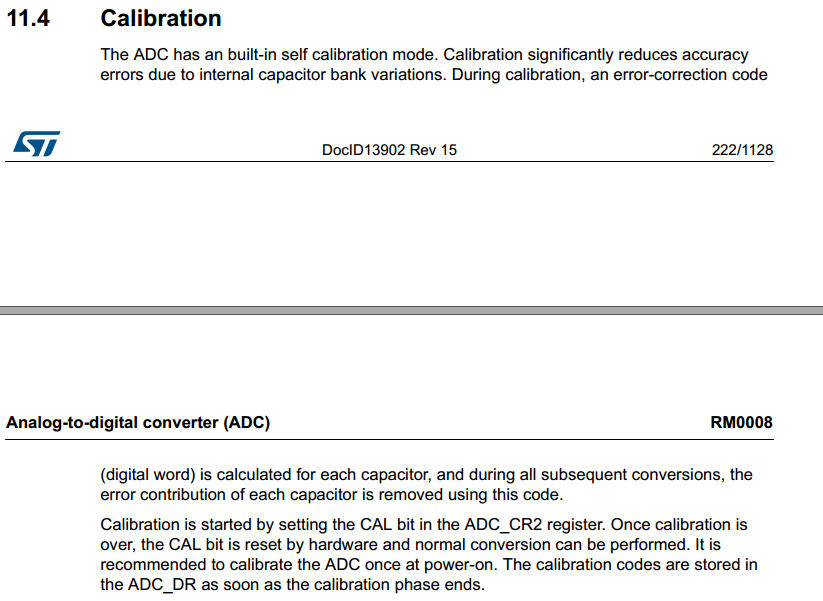

According to the datasheet, there will be a calibration code after the calibration. Is this calibration code the offset error? If it is, where does the zero input used by the offset error come from? Is it taken from the ground? I would like to know if this calibration code will be affected by power supply noise.

Posted on August 07, 2017 at 09:08
Thanks, it is in the STM32F10XXX RM0008
Posted on August 07, 2017 at 14:53
Hello Huang!!
'Is this calibration code the offset error?'
In case you mean that you must add this code to next adc calculated values. . No its not.
By reading
https://my.st.com/content/ccc/resource/technical/document/application_note/group0/3f/4c/a4/82/bd/63/4e/92/CD00211314/files/CD00211314.pdf/jcr:content/translations/en.CD00211314.pdf
it is  almost clear that is, an internal callibration procedure. 'calibration codes or parameters' are stored someway in the internal memory after calibration, and used in next conversions to correct ADC values.
Though it is not clearly written what to do with theese values (it is not written also that must do something)
You can dig to HAL,SPL  ADC functions . No any value added subtracted or with any other way
has been taken into account,
to calculate the final value.
The other question 'will be affected by power supply noise' is general.
Everything is affected from noise , we can only discuss  about of quantity of noise immunity.
Reading the above document , you will find that  the VDDA stability is fundamental for ADC accuracy.
Also VCC noice affects the ADC.
From Datasheet you will find that guaranteed accuracies are given  after this calibration take place..

Posted on August 07, 2017 at 18:57
Dears,
That is correct. Our automatic offset Calibration on STM32F1xx  is done versus VREF- ground pad.  on some packages that pin is bonded to VSSA/VSS,  so of course at that time ( an internal AIN is connected to VREF- and will be compensated  by HW in the DR Register)  you need to have a clean ground and avoid an activity on digital signals of your board .
