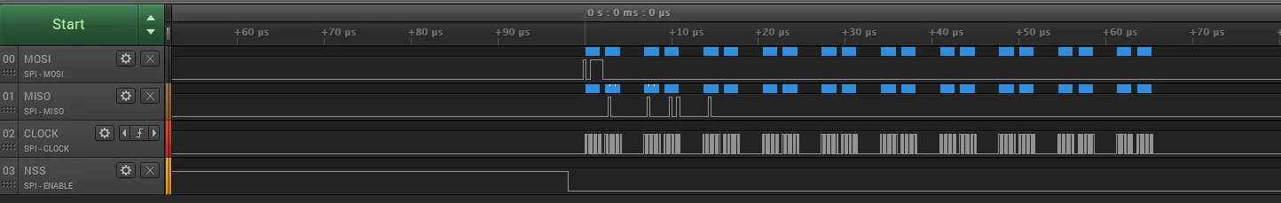

I'm tring to read and write data from a SPI Flash Memory M25P40 with an STM32F103VDT
As first try, I started to read the flash memory serial number.
I used Cube32Mx to generate the initialization code.
This is the SPI3 initialisation function:

I configure the SPI to use the Interrupt and this is my SPI code:

As you can see in the above code, the semaphore is released by the Tx/Rx/TxRx interrupt.
When I try to perform a simple serial number read, the Rx Interrupt is not raised.
This is the code to read the flash memory serial number:
opResult = SPI_Write( SPI_EFLASH, 0x9F, 1, EFLASH_WRITE_COMMAND_TIMEOUT );
/* The serial number has 20 bytes */
opResult = SPI_Read( SPI_EFLASH, buffer, 20, EFLASH_READ_COMMAND_TIMEOUT );�?�?�?�?
Unfortunately, the read operation fails dut to semaphore timeout. This happens because the Rx interrupt is not raised.
I also the SPI communication with a logic analyzer and the serial number bytes are exchanged on the SPI ad you can see in the below image:
Any suggestion?
I checked everything... But maybe I forget something.
Thanks!
