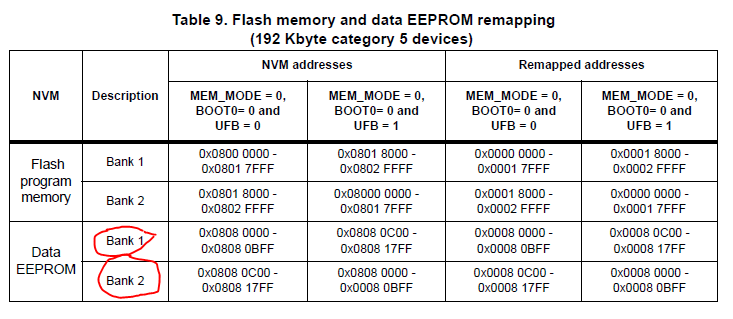

Starting a project involving EEPROM or FLASH erase/program begins with carefully reading the manuals:
The datasheet (DocID027101 Rev 3) says:
Flash program and data EEPROM are divided into two banks. This allows writing in one bank while running code or reading data from the other bank.
The reference manual (DocID025942 Rev 8) says:
Tesla DeLorean
