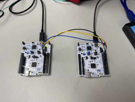

I used two NUCLEO-H503RB boards, one as a controller and the other as a target. I connected them as shown below.

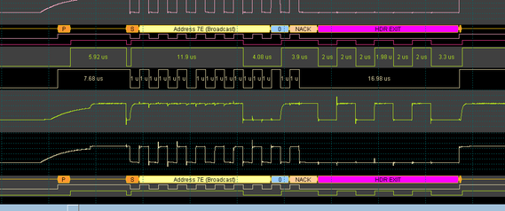

And I tried them with the Example code "I3C_Controller_Private_Command_IT & I3C_Target_Private_Command_IT",but the target always responds with a NACK.
I have tried changing the frequencies for both open-drain and push-pull modes, but the problem persists.

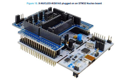

Could you advise on how to resolve this issue? Also, is my wiring correct? I noticed in the PDF that an interface board is plugged into the NUCLEO-H503RB. Could this be causing the issue? If so, is there an alternative board I can use instead of the X-NUCLEO-IKS01A3, since it seems it's no longer available?

Hello @Vinc_L ,
First of all make sure that the dynamic addressing process is done.
May this WIKI helps you for dynamic addressing Getting started with I3C - stm32mcu
