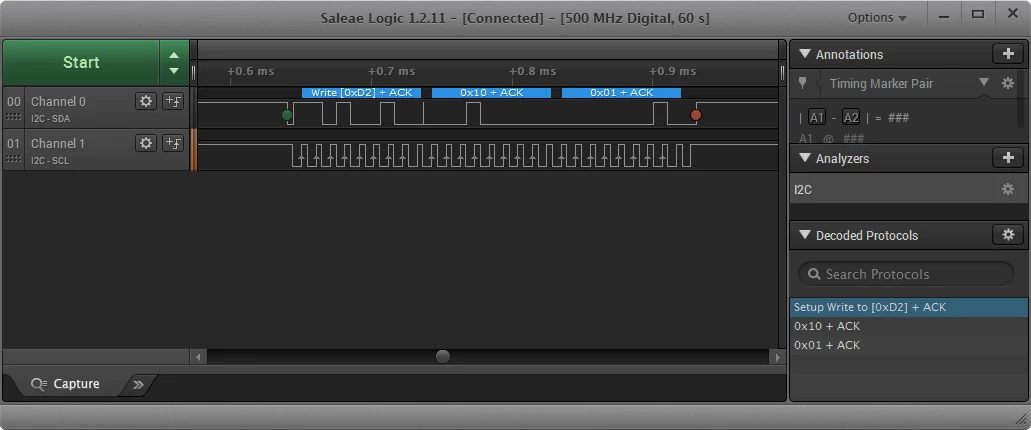

So I'm waiting until the bus is free. But after the first transmit, the HAL_I2C_GetState never get ready!
The logic analyser detects a ACK for the  RTC.
Could someone help me? I read a lot of forum sides, but do not found a concret solution for this problem.

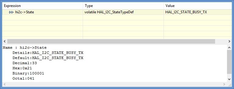

Roger Heil
January 19, 2017
Posted on January 19, 2017 at 09:32
I made a snapshot of the variable, when the system runnes inside the HAL_I2C_GetState.
regards Roger
waclawek.jan
January 19, 2017
Posted on January 19, 2017 at 23:23
And the interrupt handlers are set how?
