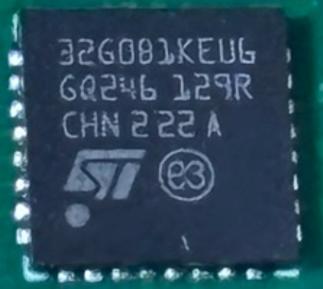

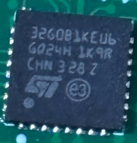

I have another batch mcu where the mcu is not entering the bootloader mode even after making boot pin high. I have attached its image and description below,
We are encountering an issue with STM32G0B1KEU6 microcontrollers from two different batches, where one batch is successfully entering bootloader mode after making the BOOT pin high and toggling the RESET pin (low to high), while the other batch fails to do so, even with the same handling.
Here are the details of the two batches:
  • First Batch 20% (MCU entering bootloader mode successfully after BOOT/RESET pin handling):
    • Marking: 32G0B1KEU6
    • Code: 6024H 1K9R
    • CHN 328 Z (Image attached)
  • Second Batch 100% (MCU not entering bootloader mode, despite correct BOOT/RESET pin handling):
    • Code: 6Q246 129R
    • CHN 222 A (Image attached)
Issue Description:
  • For the first batch, the MCU enters bootloader mode as expected when we bring the BOOT pin high and toggle the RESET pin from low to high.
  • For the second batch, following the same procedure does not result in bootloader mode. Additionally, the MCU holds the I2C clock line and does not respond at the default bootloader slave address (0x5d).
We suspect there may be differences in the configuration between these two batches, such as silicon revisions, option byte settings, or pre-installed firmware, that are affecting the bootloader behaviour.
I also tried the workaround avoids resets (except POR or option byte change). Handling only boot pins still the MCU holds the I2C clock line and does not respond at the default bootloader slave address (0x5d).
We appreciate your assistance in resolving this issue and any documentation or resources you can provide.
Thank you for your support.
Hi @Saideepak ,
Face to current situation, the recommendation I can give is to have contact with your FAE and start a FAR (Failure Analysis Request) to understand the problems root-causes.
Keep us informed.
