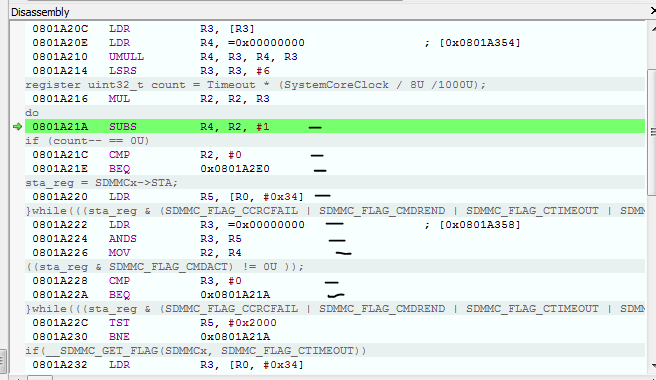

Bonus: I have disassembled this code and counted 9 instructions instead of 8 (as written in the comment). below is the image
Disassembler:
