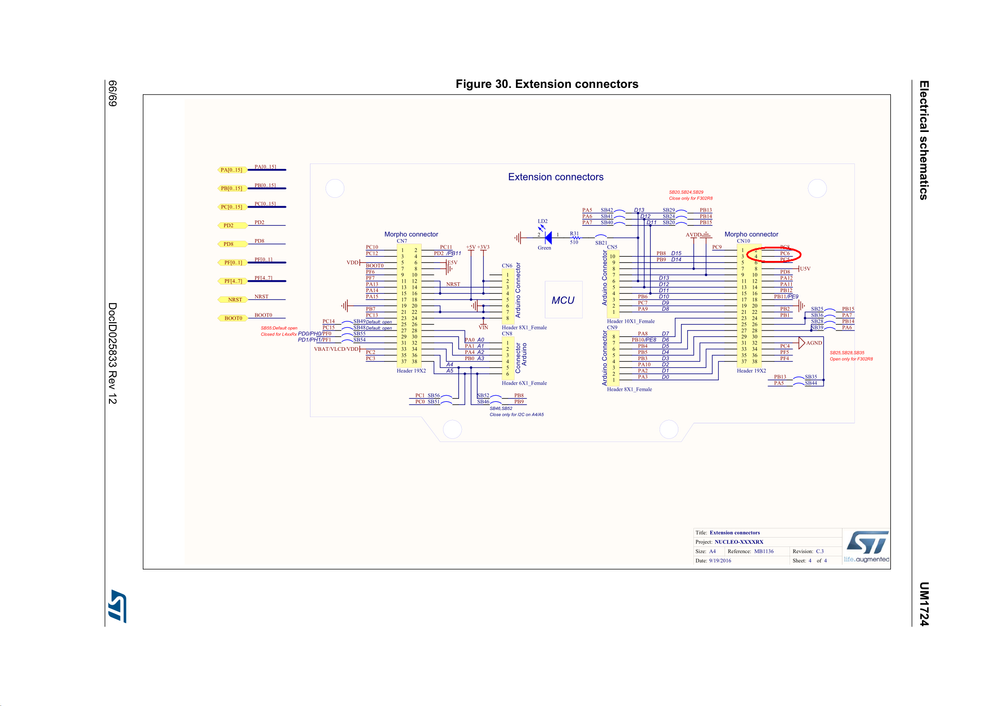

I'm working with a nucleo board f401re and I want to use the usart 6 through PC6 (tx) and PC7 (rx). I'm connected to the D15 and D9 board pin respectively. I correctly initializate the peripheral but it doesn't work. Any advise?

PC6 is not brought out to the Arduino connector (i.e. it is NOT D15), only to the Morpho connector CN10 (just opposite to PB8, which actually *is* D15).
