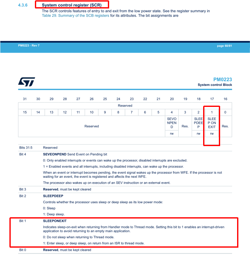

I'm using an STM32G0. The CPU is in STOP MODE and is woken up by RTC. There are also ISR generated by the GPIOS. Is there any way for ISRs to return the processor to STOPMODE on their exit? BR Gilberto

waclawek.jan
waclawek.janBest answer
June 8, 2023
_legacyfs_online_stmicro_images_0693W00000dDQhcQAG.pngJW
