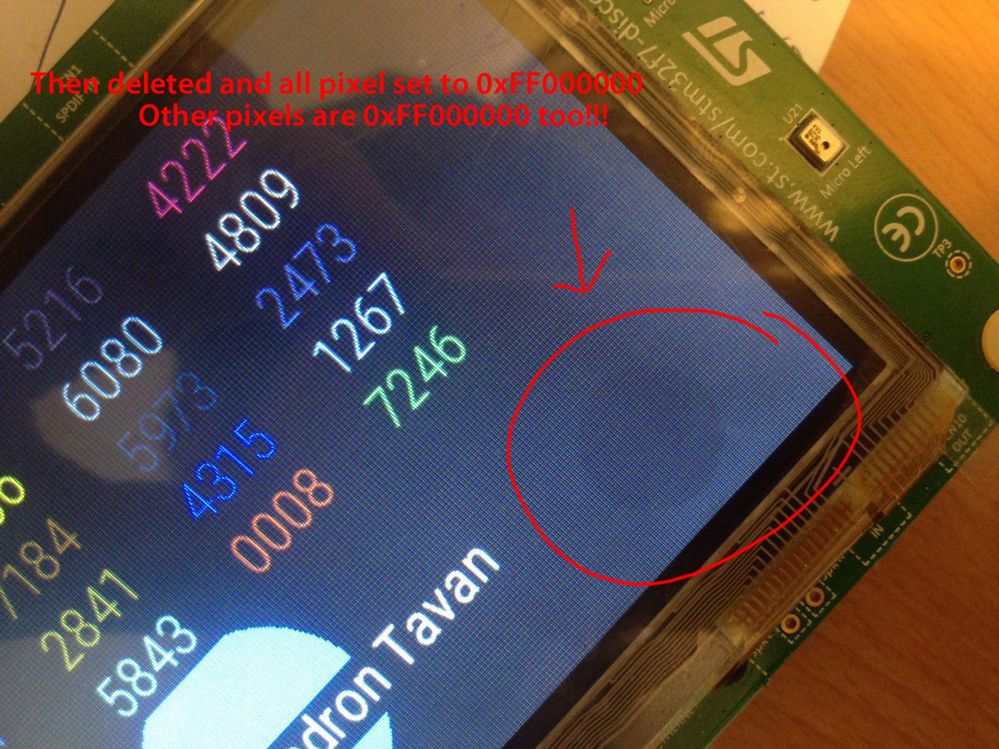

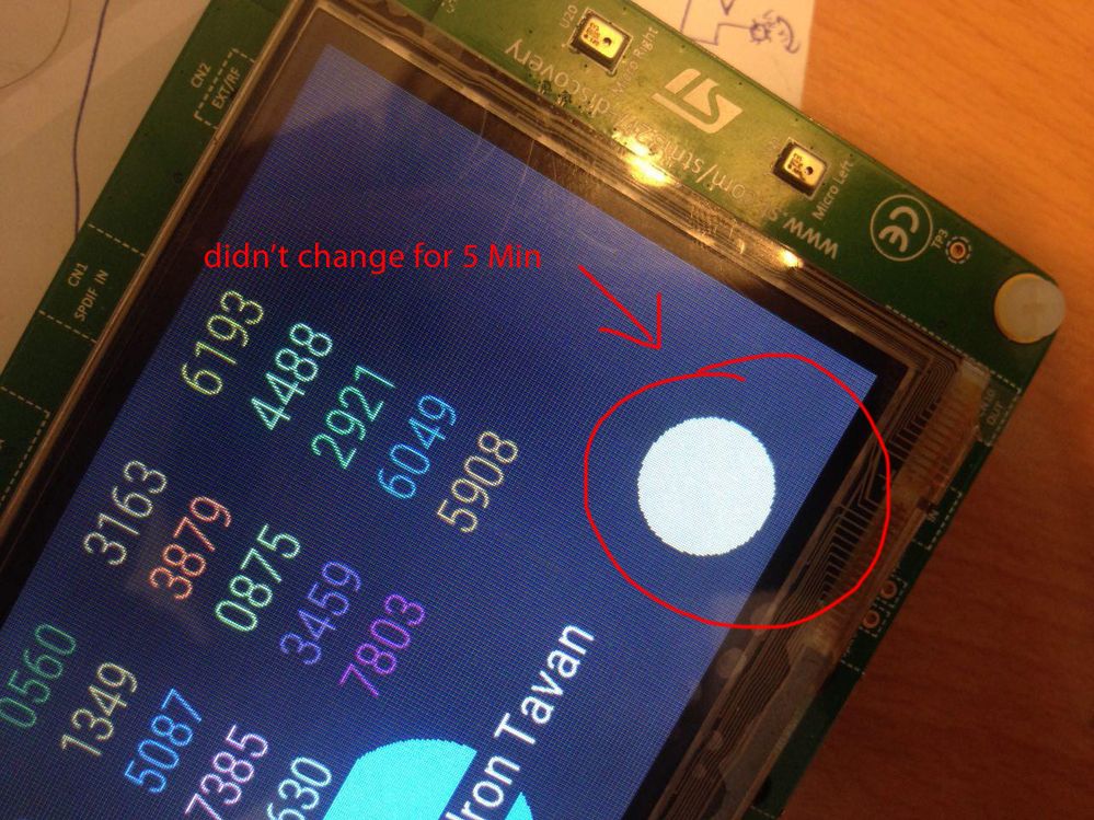

Its very strange to me .. I tried to recognize the problem by checking all datasheets information and search for same situation in the net, but unfortunately I find nothing .. please help me.
the base issue is when i render some thing in TFT lcd and don't change it for a while ( minutes or hours ) and then change it to dark, a light shadow of last image can be seen on the place. it was very surprising to me because as I know this issue was for old CRT displays and not for LCDs and I'd never seen any same problem with my other TFT based LCD projects. so is it true pixels of a LCD could become spoiled because of no changing awhile, or there is other problem that I cant see!!.
an other point is the shadow is faded out and cleared by passing time ( about 10 minutes )  but NOT by reset or power off !!!

Actually I'm sure about bad quality off this product's lcd panel because of bad color contrast , a lot of flicking , bad viewing angle and .... but I was surprised because i'd never seen same thing in other bad quality LCD panels , at least not for small periods .. this panel get
persistence effect in less than one minute ( I've just tested it ) !!!. so i doubt maybe refresh frequency is an important factor and again I can't solve problem by changing refresh rate and pixel frequency in tolerable range.

I agree - a common problem with many LCD displays as well, not only CRT.
I've seen panels in industrial applications that were hardly readable at all, for exactly the same reason.

I just sold the STM32F746G-DISCO board so I cannot show it now.
I have several newer boards (STMF412, STMF469) but I have not tested them yet for this issue - but I only seen it on the mentioned STM32F746G-DISCO board. It was completely new board - one of the first boards sold by the ST.

We recently had the same exact problem but it seemed to resolve itself with future code updates we made unrelated to this issue.  We never figured out what caused the issue.  the RockTech display they use on this eval kit though is pretty good quality.  My company uses RockTech on a number of designs without these issues.  Sorry I can't help you fix the issue, but I can tell you that there is a solution to fix it.
