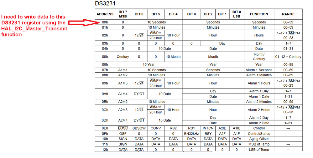

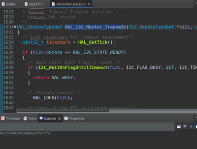

I am using I2C to transfer data from STM32F4 to DS3231 Real Time Clock registers.
HAL_I2C_Master_Transmit(I2C_HandleTypeDef *hi2c, uint16_t DevAddress, uint8_t *pData, uint16_t Size, uint32_t Timeout)
*hi2c - I2C structure
DevAddress - Device address
*pData - I don't understand this parameter.
It is written on the Internet that this is a pointer for data, but this pointer is used to transfer the register address in the Slave device.
Size - data size in Bytes.
What parameter should the data be passed?
I can use the HAL_I2C_Mem_Write function. This function has a parameter for data transfer.
This parameter is also called *pData
HAL_I2C_Mem_Write(I2C_HandleTypeDef *hi2c, uint16_t DevAddress, uint16_t MemAddress, uint16_t MemAddSize, uint8_t *pData, uint16_t Size, uint32_t Timeout)
int main()
uint8_t RegisterAddress=0x0;
HAL_I2C_Master_Transmit(&hi2c1, 0xD0, &RegisterAddress, 1, 1000 );
I think that something is wrong with the &RegisterAddress parameter, but I don’t understand how it will be right.
As a result, I need to write data to the I2C Slave Device at the address I chose.
Best answer by TDK
Yes, you can also use HAL_I2C_Master_Transmit. It expects the address first, then the data, so you need a buffer with that in it, and then send all bytes.
So to write the value 42 to address 0:
uint8_t data[2] = {0, 42};
HAL_I2C_Master_Transmit(&hi2c1, 0xD0, &data, 2, 1000);

In this code, data is passed through the *pData parameter.
And how does the HAL_I2C_Master_Transmit function know at what address this data should be written?
DevAddress(second parameter) - is the address of the I2C Slave Device, not the address where data should be written to.
The address for the register that contains seconds in the DS3231 is 0x0.
August 16, 2023
You want HAL_I2C_Mem_Write.
uint8_t data = 0;
HAL_I2C_Mem_Write(&hi2c1, 0xD0, 0, I2C_MEMADD_SIZE_8BIT, &data, 1, 1000);

I am trying to use HAL_I2C_Master_Transmit in the same way as HAL_I2C_Mem_Write.
Aren't they similar functions?
Can't the HAL_I2C_Master_Transmit function do the same as the HAL_I2C_Mem_Write function?
TDKBest answer
August 17, 2023
 > HAL_I2C_Master_Transmit(&hi2c1, DS3231_ADDRESS, 0x00, 1, 1000);
This is buggy code, don't do this. It expects a pointer, not data.

Ok, very interesting, I have not seen this information anywhere.
I managed to transfer data to the address as you wrote.
I read data from the register with the HAL_I2C_Mem_Read function.
Can the HAL_I2C_Master_Receive function read data from the register?
I tried to first transfer only the address of the register, and then read using the HAL_I2C_Master_Receive function.
But that doesn't work.
uint8_t result[10]={0};
uint8_t data[2]={0,7};
HAL_I2C_Master_Transmit(&hi2c1, 0xD0,data, 2, 1000 );
HAL_I2C_Master_Transmit(&hi2c1, 0xD0, 0x0, 1, 1000 ); //Attempt to read register 0x00
HAL_I2C_Master_Receive(&hi2c1, 0xD1, result, 1, 1000 ); //Attempt to read register 0x00
Maybe it works the same way?

Well, now it is clear that you don't know about I2C "repeated start" transactions (write then read in one transaction). You may want to google/bing/chatgpt it for better understanding.  HAL_I2C_Mem_Read does the "repeated start" thing.
MMust.5
MMust.5Author
Senior
August 17, 2023
I don't use HAL_I2C_Mem_Read
Yes, I know that HAL_I2C_Mem_Read reads the value at the selected address in one function.
What makes this function unique is that it first performs an I2C transmit operation to tell the slave device what memory address to source the data from. This is followed by a repeated start condition to begin the receive operation. The complete I2C sequence is shown below. Note that HAL_I2C_Mem_Read() is the only function capable of generating a repeated start condition in blocking mode. If a repeated start is required, it is not sufficient to call HAL_I2C_Master_Transmit() immediately followed by a call to HAL_I2C_Master_Receive().
My task was to do exactly that with the HAL_I2C_Master_Receive function.
The issue has been resolved, thanks everyone.
