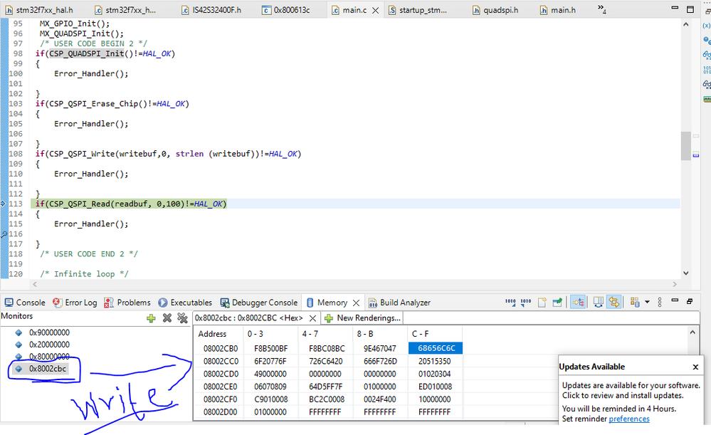

I have write the code is working fine but one specific doubt
my External memory region is 0xC000000 but my write data store 0x80002cbc and read data is 0x2000000 region
I send code and snap so anyone give the solution

You assign pointer do the string in Your Flash memory so the string is located in the Flash at address 0x80002cbc. Next You read to the buffer which is located in the RAM. That's all.

Yugenthar
Senior
Thank you sir.
This information is very important for me

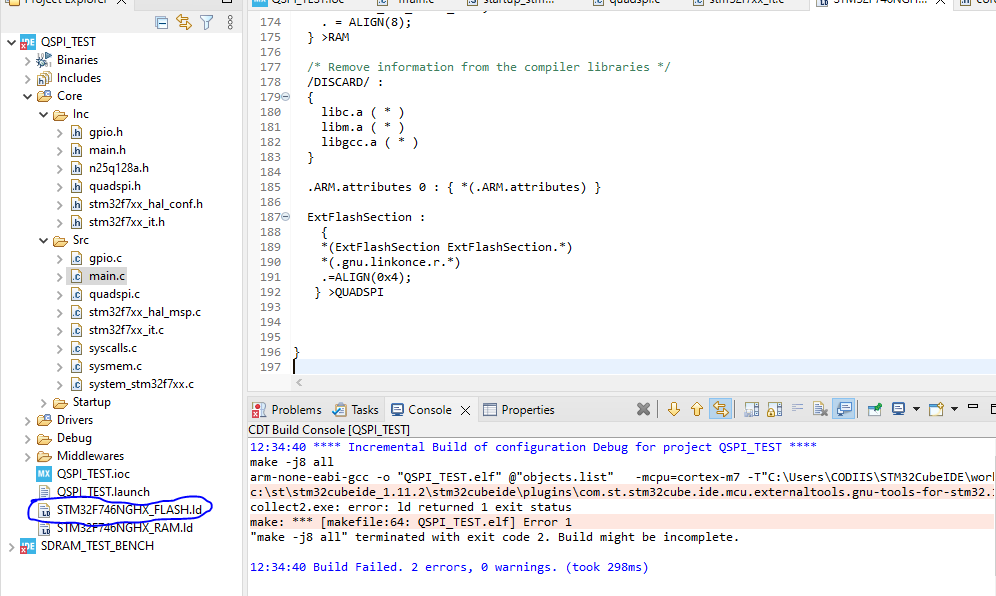

** @file        : LinkerScript.ld
** @author      : Auto-generated by STM32CubeIDE
**  Abstract    : Linker script for STM32F746G-DISCO Board embedding STM32F746NGHx Device from stm32f7 series
**                      1024Kbytes FLASH
**                      320Kbytes RAM
**                Set heap size, stack size and stack location according
**                to application requirements.
**                Set memory bank area and size if external memory is used

  ExtFlashSection :            // i am adding this five line but is error
    *(ExtFlashSection ExtFlashSection.*)
    *(.gnu.linkonce.r.*)
    .=ALIGN(0x4);
   } >QUADSPI

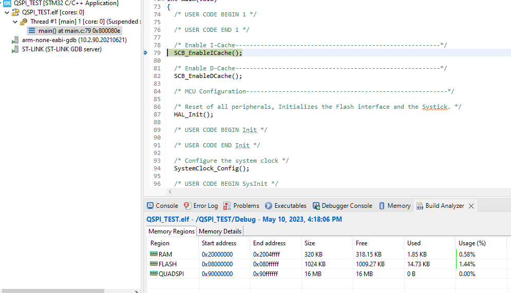

have one doubt sir ..how to write the QSPI external flash Actually I am configure the stm32f746dico board in build MT25QL128ABA1EW9-0SIT IC chip but is not working fine ..
First of all I have write the QSPI program and debug the program but not show QSPI memory window then I have write the flash id but is show error .I have send the program and snap pls give your support and help
Hai sir,
Actually I clear the error for you reference link .
but i try to write my data throught QSPI flash memory but data is store to flash memory
So i have send my and and snap and give the solution any example code or tutorial

Screen shots not real helpful.
If you get errors,show the errors, starting with the first ones.
ST provides an External Loader for the DISCO board, but you might have to select in the related user-interface / settings, probably that for the debugger. #NotMyTools
Don't erase the QSPI in the application if you've put data there in the build / download process.
Why / where are you transferring control too? Where is the application code?
Expect to have to bring up the memory, and memory map it, before you can see it in the debugger or memory windows.
