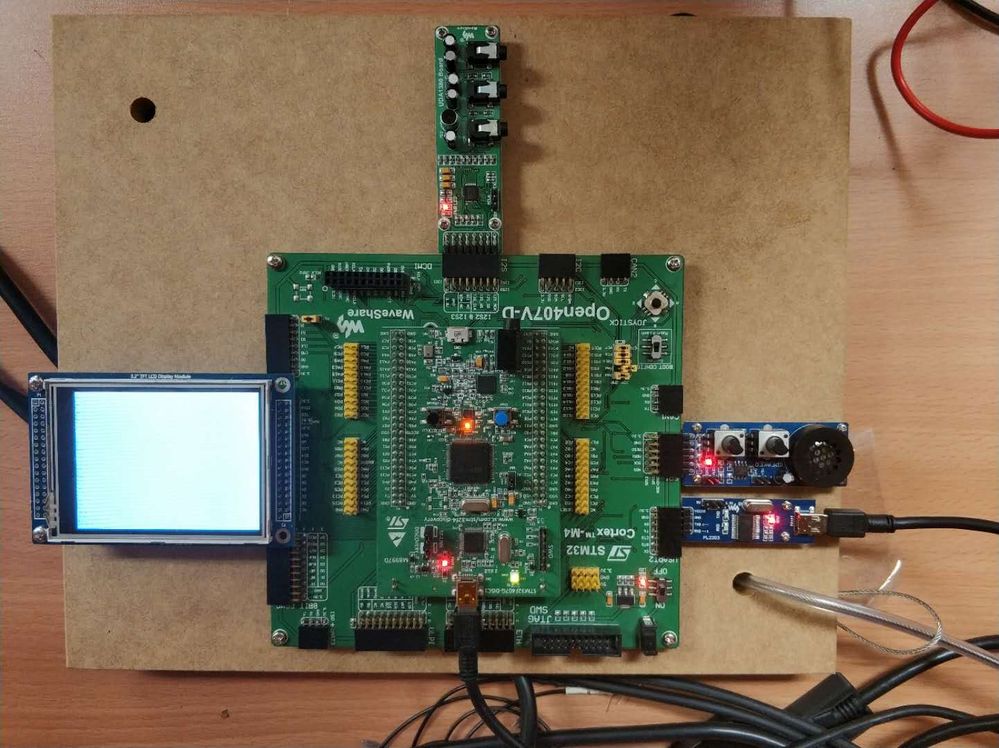

I am a totally new in code also totally new in use STM32F407 and now i doing the assignment for implementation of a state machine that will be driven by the joystick input.
Cl.1

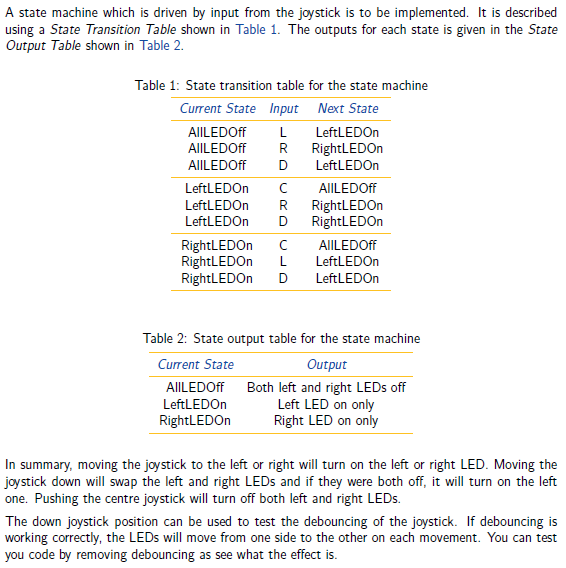

The question including in the 1st picture i want to ask that is that any material allow me to learn for coding and solve assignment question.
_legacyfs_online_stmicro_images_0693W000000VCg6.png2nd picture whole part of board

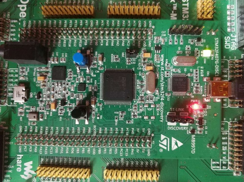

_legacyfs_online_stmicro_images_0693W000000VClB.png3rd picture is STM32F407

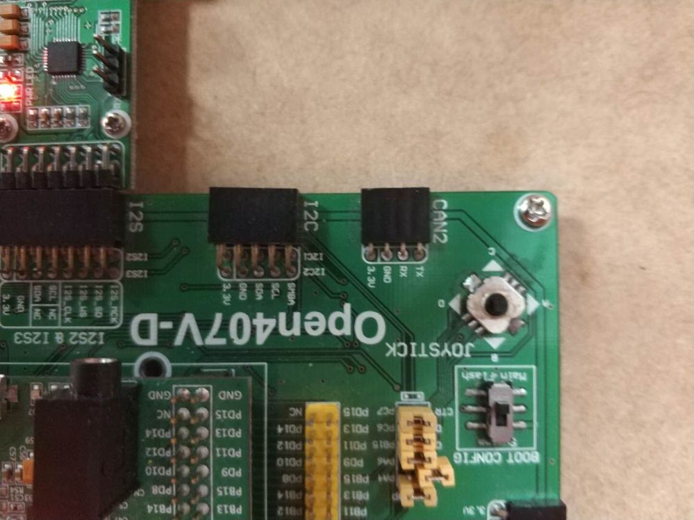

_legacyfs_online_stmicro_images_0693W000000VCkw.png4th picture is the part of the joystick

The "State Machine" is really a mechanism where you advanced based on where you are currently and the next path you take base on input.
You want a switch/case statement to separate the current state, and then in each case change the next state based on the joystick input.
Following that you want a second switch/case statement which takes the state and translates that into the LED on/off desired to represent it.
How the tool chain works seems secondary to the underlying need to apply the logic the assignment asks for.

@Cl.1​ The key to implement the code is table 2: it explains what to do when you move from one state to another.
So, whenever you get the joystick input and change state according to it, just set all LEDs at once, as required for the new state, per table 2.
So the flow is like this:
START: state = AllLedOff
NEXT: set_all_leds(state)
input = wait_input()
state = find_new_state(input)
goto NEXT
Good luck.
-- pa

I understand the theory about this assignment do u have any other related reference about it?
Definitely correct i need to coding to control the LED work following by the step in the 1st picture i inlcuding in my question.
