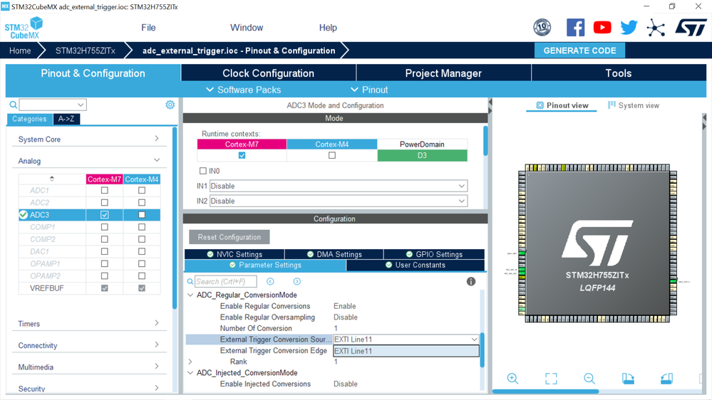

As the title says, I need to use the ADC's external trigger designator pin to trigger the transition. I have done the necessary steps on Cubemx but my code still cannot work.
Looking forward to hearing from the forum.
Thanks,
HAILV

static void MX_ADC3_Init(void)
  /* USER CODE BEGIN ADC3_Init 0 */
  /* USER CODE END ADC3_Init 0 */
  ADC_ChannelConfTypeDef sConfig = {0};
  /* USER CODE BEGIN ADC3_Init 1 */
  /* USER CODE END ADC3_Init 1 */
  /** Common config
  hadc3.Instance = ADC3;
  hadc3.Init.ClockPrescaler = ADC_CLOCK_ASYNC_DIV6;
  hadc3.Init.Resolution = ADC_RESOLUTION_14B;
  hadc3.Init.ScanConvMode = ADC_SCAN_DISABLE;
  hadc3.Init.EOCSelection = ADC_EOC_SINGLE_CONV;
  hadc3.Init.LowPowerAutoWait = DISABLE;
  hadc3.Init.ContinuousConvMode = DISABLE;
  hadc3.Init.NbrOfConversion = 1;
  hadc3.Init.DiscontinuousConvMode = DISABLE;
  hadc3.Init.ExternalTrigConv = ADC_EXTERNALTRIG_EXT_IT11;
  hadc3.Init.ExternalTrigConvEdge = ADC_EXTERNALTRIGCONVEDGE_RISING;
  hadc3.Init.ConversionDataManagement = ADC_CONVERSIONDATA_DR;
  hadc3.Init.Overrun = ADC_OVR_DATA_OVERWRITTEN;
  hadc3.Init.LeftBitShift = ADC_LEFTBITSHIFT_NONE;
  hadc3.Init.OversamplingMode = DISABLE;
  if (HAL_ADC_Init(&hadc3) != HAL_OK)
    Error_Handler();
  /** Configure Regular Channel
  sConfig.Channel = ADC_CHANNEL_3;
  sConfig.Rank = ADC_REGULAR_RANK_1;
  sConfig.SamplingTime = ADC_SAMPLETIME_1CYCLE_5;
  sConfig.SingleDiff = ADC_SINGLE_ENDED;
  sConfig.OffsetNumber = ADC_OFFSET_NONE;
  sConfig.Offset = 0;
  if (HAL_ADC_ConfigChannel(&hadc3, &sConfig) != HAL_OK)
    Error_Handler();
  /* USER CODE BEGIN ADC3_Init 2 */
  /* USER CODE END ADC3_Init 2 */
  * @param None
  * @retval None
  /* GPIO Ports Clock Enable */
  __HAL_RCC_GPIOF_CLK_ENABLE();
  __HAL_RCC_GPIOH_CLK_ENABLE();
  __HAL_RCC_GPIOD_CLK_ENABLE();
  /*Configure GPIO pin : PD11 */
  GPIO_InitStruct.Pin = GPIO_PIN_11;
  GPIO_InitStruct.Mode = GPIO_MODE_IT_RISING;
  HAL_GPIO_Init(GPIOD, &GPIO_InitStruct);

Hello @Ru?i​ ,
First we need to enable continuous conversion mode otherwise after single conversion, ADC will stop and we have to restart it.
Also make sure you enable the interrupt in the NVIC tab.
 I think you have the same issue reported in this thread.
