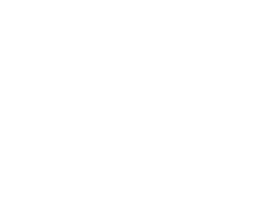

I'm trying to check I3C protocol between IKS02A1 with NUCLEO-H503RB.
and I just followed the guide which is below link.
https://wiki.st.com/stm32mcu/wiki/Getting_started_with_I3C
And I also tried I3C_Controller_Private_Command_IT code from the github.
But it seems there is NACK from the SLAVE. I've attached the scope shot.
Maybe I missed something of board setting? please give me some advice.
Thanks.
1 REPLY 1
Foued_KH
Hello @LukeJang522 ,
Could you please use X-NUCLEO-IKS01A3 because IKS02A1 doesn't support I3C protocol .
Let me know!
Foued
