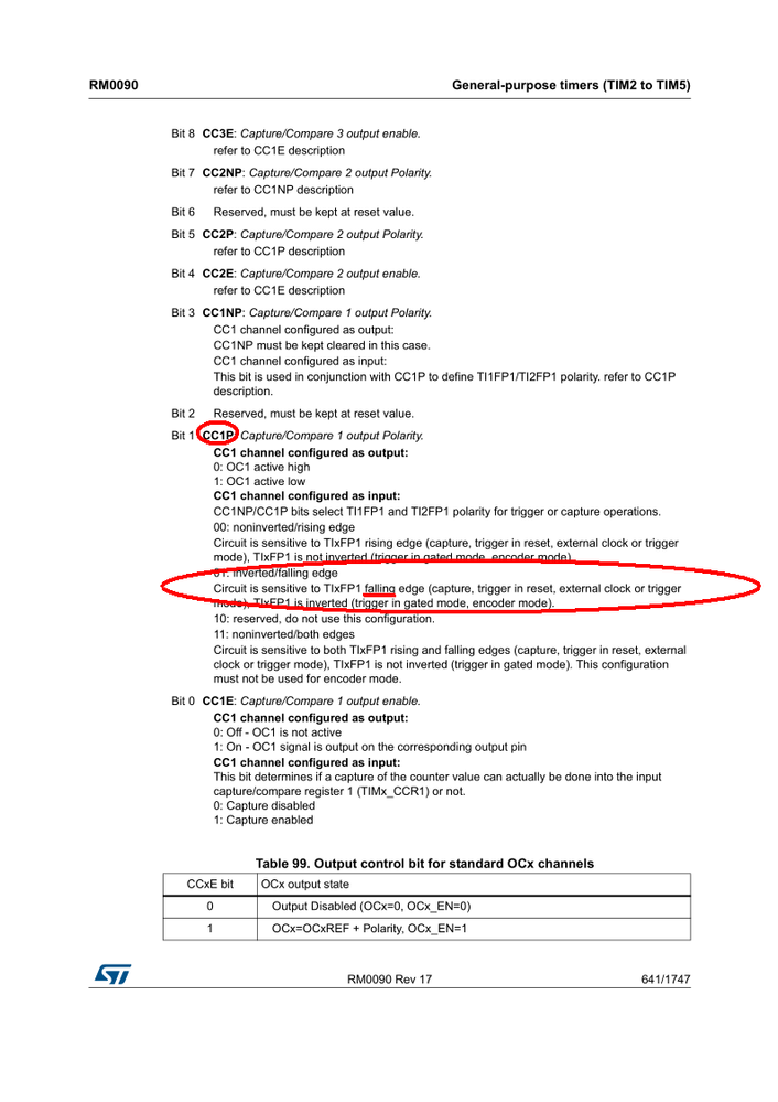

but we are not sure , whether the program enters the ISR on the rising edge of the external clock input.We are having this doubt because we tried toggling a pin in ISR and we found that the pin toggles on the falling edge of the Clock.
How can i verify this?Please reply asap......

‎2019-01-15 6:53 AM
> TIM1->CCER |= TIM_CCER_CC1P | TIM_CCER_CC1E; // rising edge
No.
‎2019-01-15 11:33 PM
Thanks for your support . The program worked fine when changing the trigger edge of external clock pulse .
