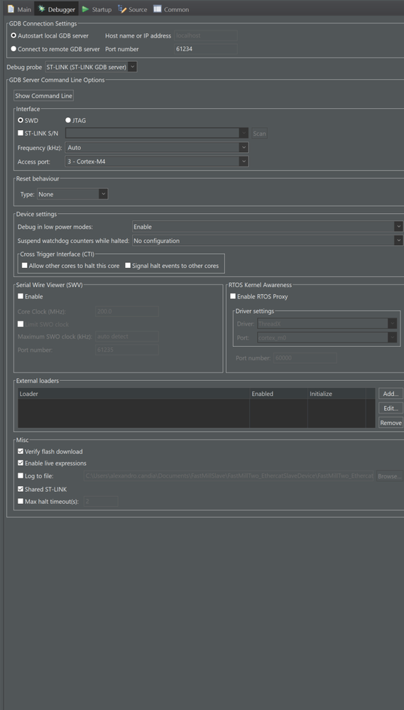

Hey Everyone,
I am having an issue with the stm32h755 dual debugging. Im trying to run cm4 by itself without cm7.
But the issue im having is, whenever I reset the MCU and check the SPI lines, I see a clock running. When I debug just cm4, I do not see the SPI clock at all. As if my Cm4 is not running on its own properly.
Is there a way I can debug just the cm4 inside the stm32h755?
I did follow guides online, I have halt all cores unchecked, I setup the flashing correctly as well.

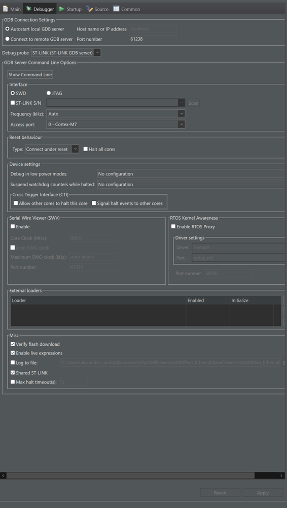

ACand.3
The only way I can have spi running is if I run both cores at the same time ( I select both main threads to run) and then I can see the spi working on cm4. But my other issue is, I have a breakpoint on my cm4 code before calling spi, but when I click "resume" on both main threads, the debugger skips the breakpoint and proceeds with my code.
