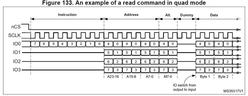

I am working on interfacing IS25LP128 128Mbit QSPI Flash with STM32H743 Nucleo board. I am running into problem with how the QSPI controller is driving the NCS line. The flash requires that the chip select remains low between command and data read/write operations. But the way QSPI HAL APIs are provided, it required two different calls. First to set command, and second to transmit or receive data.
The problem is that the QSPI controller drives NCS high between these call, and the flash reject the transaction. Is is something I am missing in using the QSPI HAL driver? Has anyone found any solution for this?

  if(HAL_OK == HAL_QSPI_Command(phqspi, &rdRegCommand, HAL_QPSI_TIMEOUT_DEFAULT_VALUE))
/* At this point, the NCS goes high */
    /* Receive EFD Read Register data from QSPI Line */
    if(HAL_OK == HAL_QSPI_Receive(phqspi, pdata, HAL_QPSI_TIMEOUT_DEFAULT_VALUE))

Hello @Joyabb​ ,
Welcome to the STM32 Community :smiling_face_with_smiling_eyes:
Could you please share your screenshot of output command signals that you see in the oscilloscope ? and what is really the command you send?
Imen
Tesla DeLorean
Guru
December 11, 2020
Pretty sure it's not supposed to go high normally between the phases.

JoyabbAuthorBest answer
January 18, 2021
Turns out it was an understanding error on our part. The CS is driven absolutely fine by the QSPI controller.
