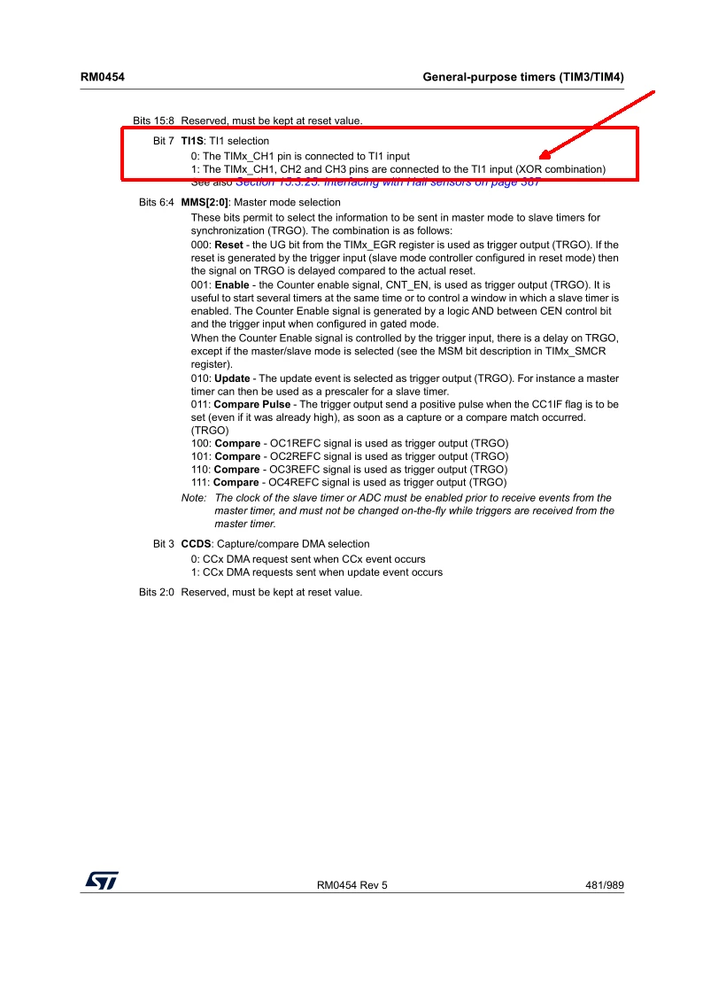

How to configure Timer input XOR for STM32G030K6T6 Microcontroller ?

_legacyfs_online_stmicro_images_0693W00000bkHuLQAU.pngJW

Thank you for your response.
I tried with the STM32F1 series it worked well. when I did with the STM32G030K6t6 it doesn't work
when there is any change in the input TIM counter(xor timer) reset to zero but it doesn't work in STM32G030K6t6
below I have attached my initialization TIM3 for the XOR operation

waclawek.jan
May 18, 2023
Read out and check/compare-to-working/post content of TIM registers.
