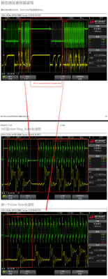

Another issue is that I cannot cancel the reserved byte when using private read
I3C_PrivateTypeDef aPrivateDescriptor[3] = \ { {TARGET1_DYN_ADDR, {aTxBuffer, 2}, {NULL, 0}, HAL_I3C_DIRECTION_WRITE}, {TARGET1_DYN_ADDR, {NULL, 0}, {aRxBuffer, 30}, HAL_I3C_DIRECTION_READ}, {TARGET1_DYN_ADDR, {aTxBuffer, 2}, {aRxBuffer, 30}, HAL_I3C_DIRECTION_BOTH} }; /*##- Add context buffer transmit in Frame context #####################*/ if (HAL_I3C_AddDescToFrame(&hi3c1, NULL, &aPrivateDescriptor[I3C_IDX_FRAME_1], &aContextBuffers[I3C_IDX_FRAME_1], aContextBuffers[I3C_IDX_FRAME_1].CtrlBuf.Size, I3C_PRIVATE_WITH_ARB_RESTART) != HAL_OK) { /* Error_Handler() function is called when error occurs. */ Error_Handler(); } /*##- Start the transmission process ###################################*/ /* Transmit private data processus */ if (HAL_I3C_Ctrl_Transmit(&hi3c1, &aContextBuffers[0],100) != HAL_OK) { /* Error_Handler() function is called when error occurs. */ Error_Handler(); } while (HAL_I3C_GetState(&hi3c1) != HAL_I3C_STATE_READY) { } if (HAL_I3C_AddDescToFrame(&hi3c1, NULL, &aPrivateDescriptor[1], &aContextBuffers[I3C_IDX_FRAME_2], aContextBuffers[I3C_IDX_FRAME_2].CtrlBuf.Size, I3C_PRIVATE_WITHOUT_ARB_STOP) != HAL_OK) { /* Error_Handler() function is called when error occurs. */ Error_Handler(); } if(HAL_I3C_Ctrl_Receive(&hi3c1, &aContextBuffers[I3C_IDX_FRAME_2],100) != HAL_OK) { /* Error_Handler() function is called when error occurs. */ Error_Handler(); }
