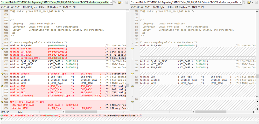

Unfortunately the target processor is a STM32F072 (Cortex M0) and the detection is not working.
The ARM documentation for Cortex M0 lists the DHCSR register:
http://infocenter.arm.com/help/index.jsp?topic=/com.arm.doc.ddi0337e/CEGCJAHJ.html
but there is no detailed description about the bit definitions or the address of the register ...
Also the CMSIS register header file shows a lack of the CoreDebug_BASE register
Is this feature simply not available for a M0 device ???

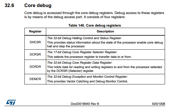

A quick implementation does not appears to be quite easy. ...
In any case I'm very confused to find a chapter 32.6 Core debug in the
https://www.google.de/url?sa=t&rct=j&q=&esrc=s&source=web&cd=1&ved=0ahUKEwiztqPv08zRAhXqI8AKHc6hAgMQFggcMAA&url=http%3A%2F%2Fwww.st.com%2Fresource%2Fen%2Freference_manual%2Fdm00031936.pdf&usg=AFQjCNEVF1UlowviGuA1sKeAucu4yZIhtg&sig2=jT-iHieXtSPfHD7fhxT2qA&cad=rja
reference manual which are obviously not available:0690X000006060IQAQ.png

Posted on December 13, 2017 at 18:42
The feature exists - but the register is not accessible to the user code running in the chip.
