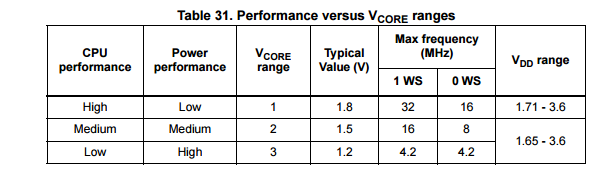

An embedded linear voltage regulator supplies all the digital circuitries except for the Standby circuitry. The regulator output voltage (VCORE) can be programmed by software to three different ranges:
  • Range 1 (VDD range limited to 1.71-3.6 V), with the CPU running at up to 32 MHz
  • Range 2 (full VDD range), with a maximum CPU frequency of 16 MHz
  • Range 3 (full VDD range), with a maximum CPU frequency limited to 4.2 MHz

In reference manual RM0367 on page 146 in 6.1.6 Dynamic voltage
scaling configuration is written:
The following sequence is required to program the
voltage regulator ranges:
1. Check VDD to identify which ranges are allowed (see
Figure 11: Performance versus VDD and VCORE range).
2. Poll VOSF bit of in PWR_CSR. Wait until it is reset
to 0.
3. Configure the voltage scaling range by setting the
VOS[1:0] bits in the PWR_CR register.
4. Poll VOSF bit of in PWR_CSR register. Wait until it
is reset to 0.
This doesn't work. Whatever I put on these 2 bits I always read
that is 1,5V. I tried to find if there are additional registers that I
have to set or reset like if you want to set system clock on 32MHz you
have to set certain voltage range, but I didn't find anything. I guess
that is a trivial solution but I need somebody who knows this problem.
