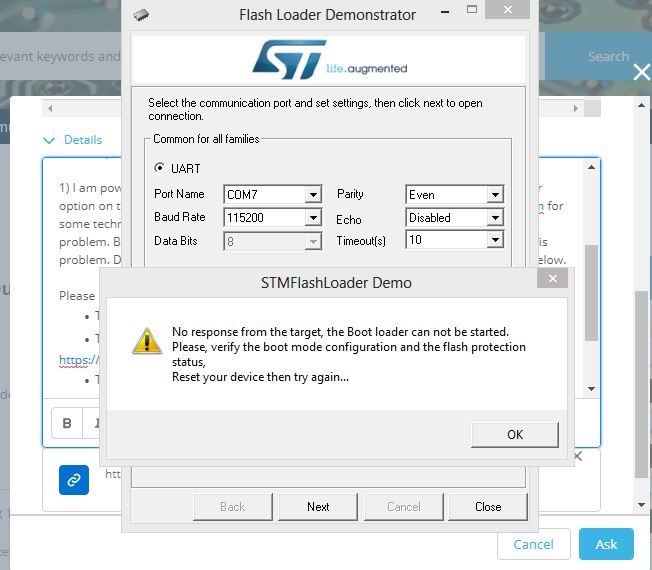

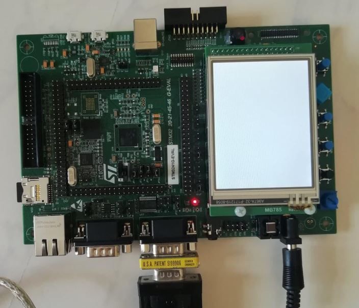

As shown in below my kit screen is completely white, is not able to see any menu?
I have searched to how to boot the kit from STM website, I found a video and an document I want to do the same process, during doing the same procedure I am getting the following error message?

hi HNory.1,
Please program the board through STLINK (USB port) - not through RS232.
Regards
Igor
