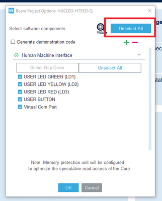

Have got the NUCLEO-H755ZI-Q board with the STM32H755ZI chip on it and able to use the BSP package and drive the three LEDs and also perform debugging.
However, whenever tried to build a new project and select STM32H755ZI (not NUCLEO-H755ZI-Q) and configure the project based on the settings in NUCLEO-H755ZI-Q the code does not run. Nor is debugging possible. Also, used the neat Compare Projects tool; but nothing that would impact it stood out.

Hello @smallkitties3 and welcome to the community,
Simply, click on "Unselect All" button to prevent CubeMx to generate the BSP code and configure the GPIOs according to your needs.
I've attached a project where Green, Red, Yellow leds are toggling on NUCLEO-H755 board. The project was generated with CubeMx v6.13 starting from a the board (Bsp generation disabled from the beginning).
Hope that answers your question.

Hello SofLit,
Thank you for this suggestion and attaching the project. However, the process in suggestion masks the process of configuration and the Categories section (in Pinout & Configurations tab) still has the BSP listed as a remanent.
The very purpose for purchasing this development/discovery board was to learn how to design and program the onboard dual-core.
Thank you for your reply and welcome.
