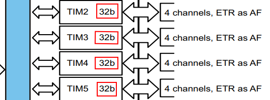

How many 32 bit timers does STM32H573 have? 2 or 4? Conflicting information in data sheet
‎2023-12-14 12:00 AM
I'm refering to DS14121 Rev 1 of STM32H573xx.
- "Figure 1. STM32H573xx block diagram" shows 4 32 bit timers (TIM2, TIM3, TIM4, TIM5)
- "Table 2. STM32H573xx features and peripheral counts" says there are only two.
Where can I find trustworthy information on the correct number?

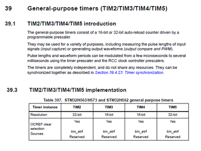

From RM0481:
‎2023-12-14 12:16 AM
From RM0481:
‎2023-12-14 12:30 AM

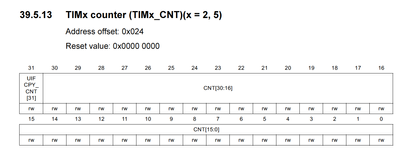

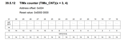

where are the missing 2 x 32 bit counters?
tim2 + 5 are 32 bit:
tim 3 + 4 are 16 bit:
and where the other 32 bit counters ?
‎2023-12-15 6:27 AM
@F71334 ,
"Yes indeed it's a typo and it will be fixed in coming revisions of the DS. Thank you for raising this up :)"
Was an answer to @AScha.3 regarding the FMAC RAM size. And there is no issue in our documentations regarding Timers. As shown in the reference manual in "TIM2/TIM3/TIM4/TIM5 introduction" section, it was said "16-bit or 32-bit". So there are two 16-bit timers and two 32-bit timers as shown in Table 397.
The best answer for your request is the first one I've already provided.
Thank you.
‎2023-12-15 6:41 AM
I'm talking about this:
As mentioned, "Figure 1. STM32H573xx block diagram".
Sorry for any inconvenience.
‎2023-12-15 7:05 AM
OK. Now it's clear. It will be fixed in coming revisions of the DS. It will be treated in the same ticket number: 168793.
