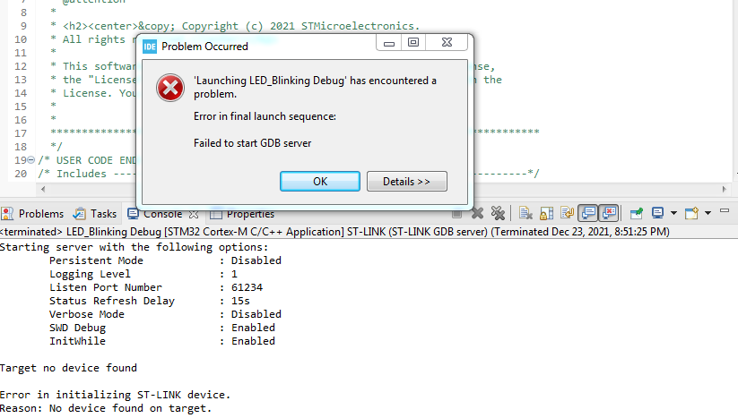

I using development board "ARM Cortex-M0 STM32F051C8T6 STM32 core board dev. board". i newly started with this, i unable to flash the code...

Make sure you've connected up the SWD connection to the ST-LINK, along with power.

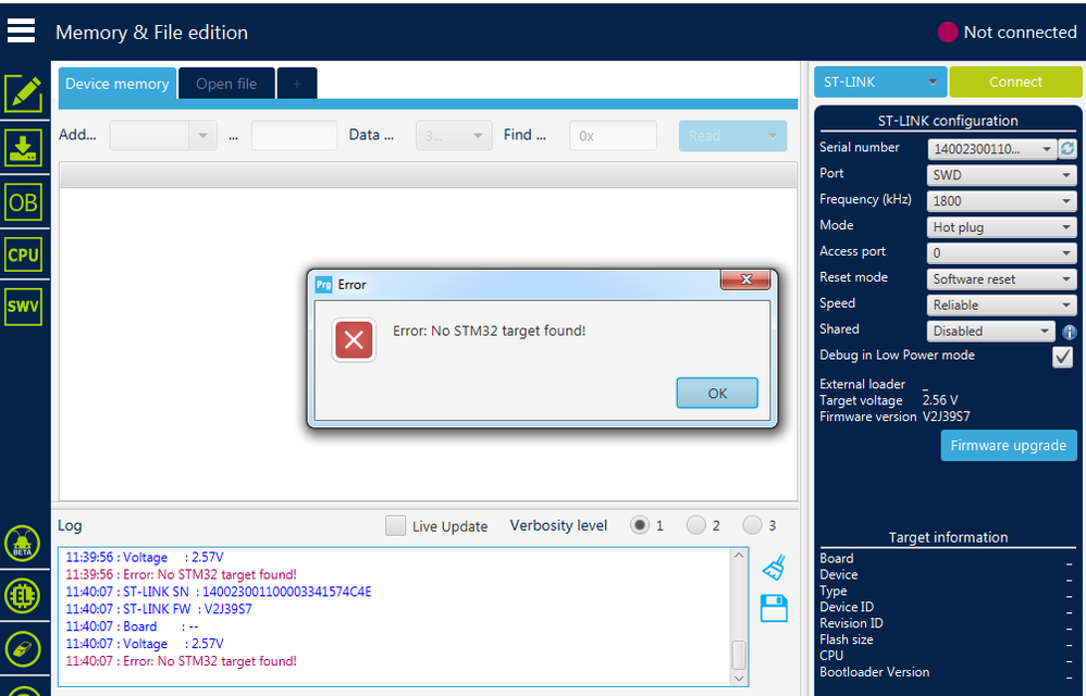

Make sure you can access the board using the STM32 Cube Programmer tool.
Pick a slower connect speed for CM0(+) devices, should work at a couple of MHz, but not 24 MHz

Yes i am giving separate power supply, i also "cannot able to access the board through program board".
Please explain third point in detail.

Yes, I am using separate ST-Link Programmer.

> Target voltage: 2.56V
Suggests the board doesn't have sufficient power, and/or isn't connected correctly. This board runs on 3.3V.
