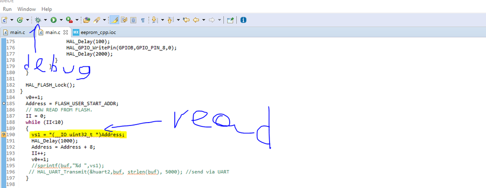

I was able to write and read from the flash memory. I verified with debugging and looking at the memory map, I wrote to 0x08002000. But after relaunching and checking if it is still there, it seems it was reset to random values. My project is taking values from sensors and calibrating and saving the calibration to flash so next time I Launch the program I can use the values saved in flash, here when I relaunch the code it resets the memory map. Can someone help and understand how to fix?
Thanks

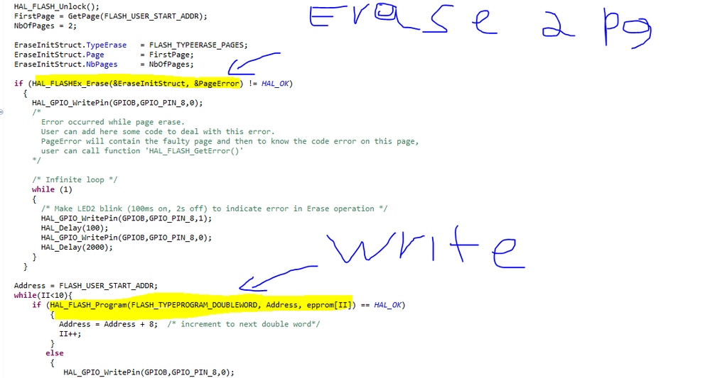

I mean by relaunching is that I run a debug session again, I am aware that might cause the reset but I can't be sure, what way can I check that?
I write from the main.c, I am attaching pictures of the erasing,writing and reading procedure.
All this program does is try to write and read to that memory so it is unlikely that my prgram writes to that memory. So maybe the environment writes to it and erases it but how can I be sure? Or how can I know where to write so it will remain there.0693W000003QXbnQAG.png0693W000003QXbiQAG.png

What's this, CubeIDE?
How do you define FLASH_USER_START_ADDR?
Observe mapfile. Is there any mention of the area you are writing to? If not, it may be OK.
Show the memory you are writing into, after the write, and after the "relaunch".
