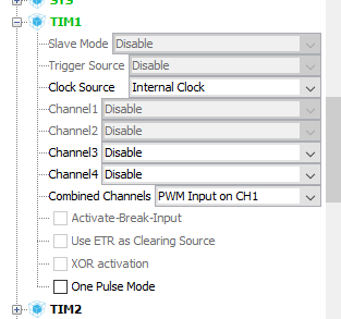

Has anybody converted the PWM frequency and duty cycle measurement exmaple from the STM32CubeMx examples to use STM32CubeMx to configure the hardware (.ioc file to configure the timers)?
Mike Katz
Posted on October 10, 2017 at 21:17
The 'STMCubeF2\Projects\STM32F207ZG-Nucleo\Examples\TIM\TIM_PWMInput' example configures the timers with direct calls to the HAL.
I am trying to keep all of the pin allocation and resource initialization within STM32CubMx itself.
Has anyone either created a .ioc file for this or measured frequency and duty cycle using STM32CubeMx to configure the timers?
Thanks in advance.
11 REPLIES 11
Posted on October 11, 2017 at 17:34
Hello!
PWM Input mode is selected from the combined channels droplist.
To start the PWM Input , in your main function, call HAL_TIM_PWM_Start (for both channels).
Inside TIM1 settings, the counter period(AR Register) must be higher than PWM period you try to measure.
regards
vf
Posted on October 13, 2017 at 00:25
Thank you for your help.
Do I need to enable the input capture interrupt or the global interrupt for the timer?
Do you have a code sample I might look over or can you point me towards some documentation?
Thanks again.
Posted on October 14, 2017 at 00:08
Hello again.
It is your choice to use interrupts or not, depending  on what you want to do. It is not mandatory.

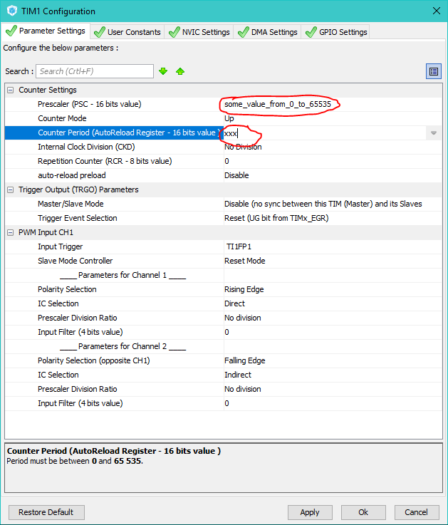

Posted on October 14, 2017 at 17:47
Thank you very much for the help.
What should the setup for the timers be in STM32CubMX?
Posted on October 14, 2017 at 21:45
Hello!
The settings are for the timer as my first's answer figure.
Additionaly, about timer's settings like below
Prescaler value  divides TIM1 clock by PSC+1 and feeds the Counter.
To have the maximum resolution from PWM Input,  AutoReloadRegster Value can be set to 65535 (maximum)  and prescaler can be adjusted, so the maximum counting period of TIM1  to be longer than measurable PWM period.
Example
Want to measure the PWM output from a RC receiver.
Desirable resolution 1 microsecond.
Max period is 20ms
we are not interesting about duty cycle that is between 1 and 2 ms because is allways shorter than period.
TIM1 clock is 120MHZ
Solution: PSC is 119 (120000000Hz /1000000Hz -1) to have 1MHz or 1 microsecond counting period.  And ARR can be above 20000 (20ms),  put 65535.
With theese settings can measure using 1us  resolution, any PWM pulse with period up to 65,5 ms (~15Hz)
Posted on October 21, 2017 at 01:43
I just wanted to say thank you.  I got this working using one of the 32
bit timers running at 60MHz.
The only thing that is surprising is the inaccuracy of about +/- 100Hz
at 38KHz and about +/-3% on the duty cycle.
Thanks again,
          Mike
