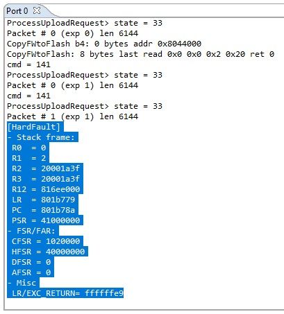

    Here are the SCB registers and the output of the Handler (not much, because i don't have the assembler code)

    http://www.keil.com/appnotes/files/apnt209.pdf
    Quick glance: looks like usage fault/unaligned.

    MFend
    March 10, 2019
    Thanks for the detailed and helpful answer. I really appreciate your timely and correct advice.
    Here's the output:
    I'm writing on page boundaries and I always write 64 bits at a time (though I see that the HAL function can be easily adapted to write 32 bits).
    Even when I just write 16 bytes, it breaks in the HardFault_Handler.
    If I enter the function with the debugger and step over each line, including   if(HAL_FLASH_Program(FLASH_TYPEPROGRAM_DOUBLEWORD, flash_ptr, dataf) == HAL_OK)
    then burning to the flash succeeds. I suspect something to do with clocks or other peripherals.
    I wrote bootloader code successfully - but except for one GPIO to show a blinking LED, the bootloader uses all of the STM's defaults on power-up.
    Now I'm in the part of the code in which I receive the new FW to be burned over RS485 communication, and write it in the 2nd half of the flash (from 0x8044000 until 0x807FFFF). Even though I disable all interrupts, something is not allowing the flash to be burned correctly.
    Whatever light you can shed on this would be appreciated.

    The dump is helpful - I'm checking the code around LR and PC...
    MFend
    March 10, 2019
    And an alignment error it was...
    I tried to cast a BYTE array to a 64-byte pointer.
    Now with the memcpy to a 64-bit variable (without the cast, there is no HardFault.
