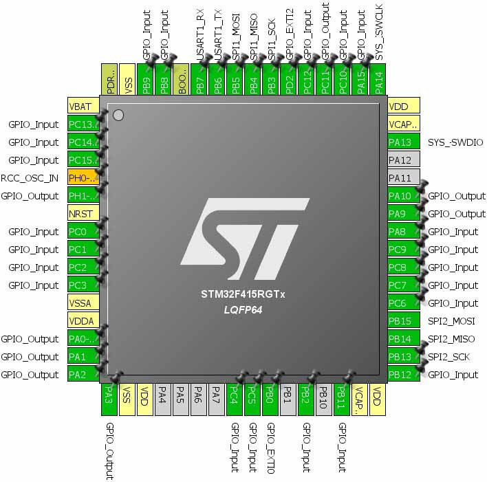

Hello, since i used all other pins inside STM32F415RG, i decided to use GPIOH pin1 as my mux enable for ADC frontedend channel selection. GPIOH pin0 is used as 25MHz CLK in from TCXO CMOS clock source.
For some reason, GPIOH pin1 is inactive, and i can't do any toggling . My original suspicion is that somewhere is is used as clk clock input for crystal, but i can't found where. code of GPIOH pin1 init:
    In your program, which includes the stuff you did not write just linked in without paying attention to it.
    This is a deserved punishment for using the ''library'' without studying thoroughly and understanding its sources. The related RCC registers tend to be manipulated in system_stm32f4xx.c.
    And read the manual, RM0090 rev.7 ch.8.3.14, plus the HSE-related issues in RCC chapter.

    Make sure to configure HSE in BYPASS mode.
    NO!
    HSE must be completely OFF for PH0/PH1 to be usable as GPIO (i.e. HSEON in RCC_CR must be 0).
    If HSE is ON, even in BYPASS mode, HSE_OSCOUT (= PH1) MUST be left floating (see RM0090 rev.7, ch.6.2.1, and the chapter I referred to above).
    One more gotcha is, that OSC_IN and OSC_OUT pins are NOT 5V-tolerant while in oscillator mode.

    Yes, while reading programming manual it does state that it should be left in HiZ mode, and it's not exactly possible to do any software toggling on this pin.
    Well, by the luck it is always in pull-up mode with some noise on this pin and i still can do multiplexing to adc, only problem is i can't disconnect MUX from my analog part.
    Anyway, only few pins was left unused in my design, and i could not used other pin.
    RCC->CR = ((uint32_t)RCC_CR_HSEON|RCC_CR_HSEBYP);
    this declaration did not helped.

    Fair play, but it will stop the pin from oscillating, and most CMOS TCXO aren't rail-to-rail either, so not being 5V tolerant hardly seems like a real burden.

    In any design i try to check if everything is ok, but i used STM32CubeMX to see if i have any conflicts, and i had none, since it was possible to select RCC_IN as CMOS clock source, and PH1 pin as GPIO_Output.
    Next time i will try to read more reference manual
