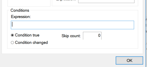

I have to store STM32F767ZI registers values at one line of my application code without halting my program at that line.
As,I am currently trying to use C-Spy for that by using which so far I have managed to store on text file register values but each time code halts at that point as I am doing it using code breakpoint.
Can you please share the solution to store GPIO register values on a file without stopping code execution (May be using C spy).

Best answer by A Maq
Posted on July 06, 2018 at 11:31
I have managed to resolve the issue by putting in an expression the C-Spy Macro.
That will make macro execute during run time to pick register values or any other macro .

I have 3 registers to pick values. And need to copy register values to a file. Have registered C-spy macro for that.therefore, arrays may not be suitable.
