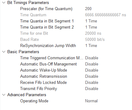

The Identifier is different for each Board.The configuration in CubeIDE looks as follows:
CAN configurationCAN configuration

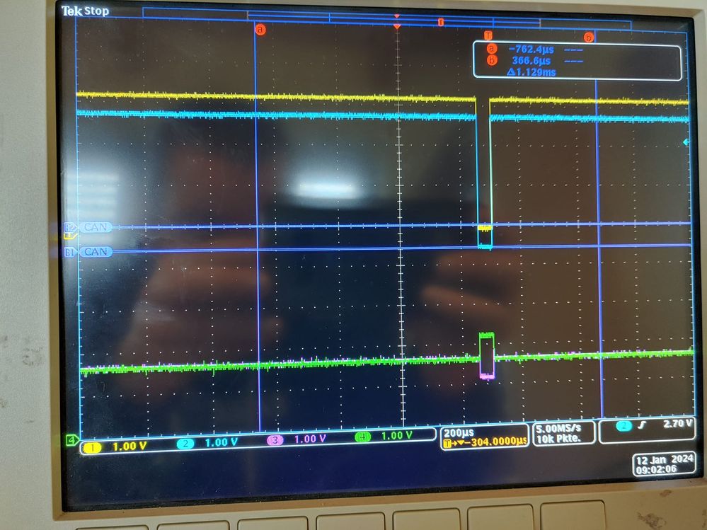

Both Boards use CAN1. When I run it in Debugging mode and set a Breakpoint at AddTxMessage and then execute the command I get the following Scope Picture:
Rx(yellow),Tx(blue) BUS(Green/Purple))Rx(yellow),Tx(blue) BUS(Green/Purple))The Tx/Rx lines are at the sending Board in debugging mode. The Rx at the recieving Board gets the signal at the Pin after the Tranciever, but no Arbitration seems to start. I get no other Signals on the bus even with a bigger sampling Window. Does anyone have an Idea why?

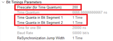

These are not correct parameters for CAN bitrate.
BS1 =1, B2 = 1, Prescaler = 200! -> very low values for BS1 and BS2 and very High prescaler value!
What is the bitrate you're looking for?
for testing I was aiming at 50kbit/s. The finished system would be closer to 500kBit/s.
Ok, first you need to change BS1, BS2 and prescaler values as I've already suggested: maximize BS1 and BS2 values and minimize the prescaler with BS1 ~=75% (BS1+BS2)
mƎALLEm
Attached a proposal of CAN bitrate communication @500Kb/s
ChristianNo
The Provided configuration worked! Thanks for your help!
