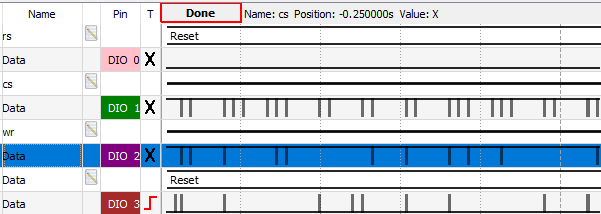

Thanks for the response @Community member​ it is quite difficult to monitor a 20 pin protocol but I quite managed to monitor 4 pins (RS , CS , WR , and one random data line) while I was constantly sending data 0xffff(image bellow) . But I think I found something more critical , from the initialization code I tried to remove all the `send_data` lines and the results on the screen was exactly the same! I can interpret that as follows: the send_data command does not work and also some initialization commands worked as they didn't require any data and some others didn't but those that worked made the screen to look like it was responding correct.
That's kind of good news because I wasn't very sure for my send_data command , I am using an stm32h7 with the fmc peripheral set at default values for mostly anything and also `Chip select pin = N1` and `LCD Register select=A16` from cubemx. Then with the configurations above I thought:
static constexpr uint32_t LCD_CMD = (uint32_t) 0X60000000;
 static constexpr uint32_t LCD_DATA = (uint32_t) 0X60020000;
These address is probably wrong for the data but what is more curious is that the LA shows some data is transmitting on the data line if I do
while(true) send_data(0xffff);
waclawek.jan
waclawek.janBest answer
July 16, 2021
Make sure the FMC falls into area which is tagged as Device in MPU.

@Community member​  Thank you so so so so so much , that little (and kind of cryptic :squinting_face_with_tongue: ) message helped a lot it worked on my first trial , I 'll leave this link here as a reference as I don't like removing duplicate questions https://community.st.com/s/question/0D50X00009XkWQESA3/stm32h743ii-fmc-8080-lcd-spurious-writes
