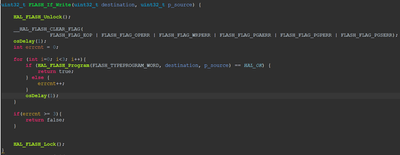

Hello, Flash writing is not working.
When i update firmware, then Writing is working well only one time.
But after this time, result is fail in HAL_FLASH_PROGRAM()
MCU : STM32F446RCT7
Thanks.

Please use the code pasting tool </>  and not bitmapped screen shots.
Working once suggest you fail to erase the blocks on the second go around.
You don't show enough code to fully convey the context.

hello,
Before you program the flash, you need to erase it first.

Oh i see.
Then for example, when i use 0x0801FFF0 address for flag, how can i erase only 0x0801FF0 address?
Do you have any solution?
