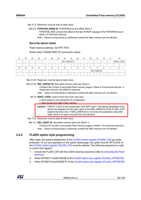

waclawek.jan
Maybe you may try to check state of BOOT_LOCK before trying to set RDP1.
I don't know why would BOOT_LOCK be set, but maybe this is the mechanism through which the chips are "lost".
